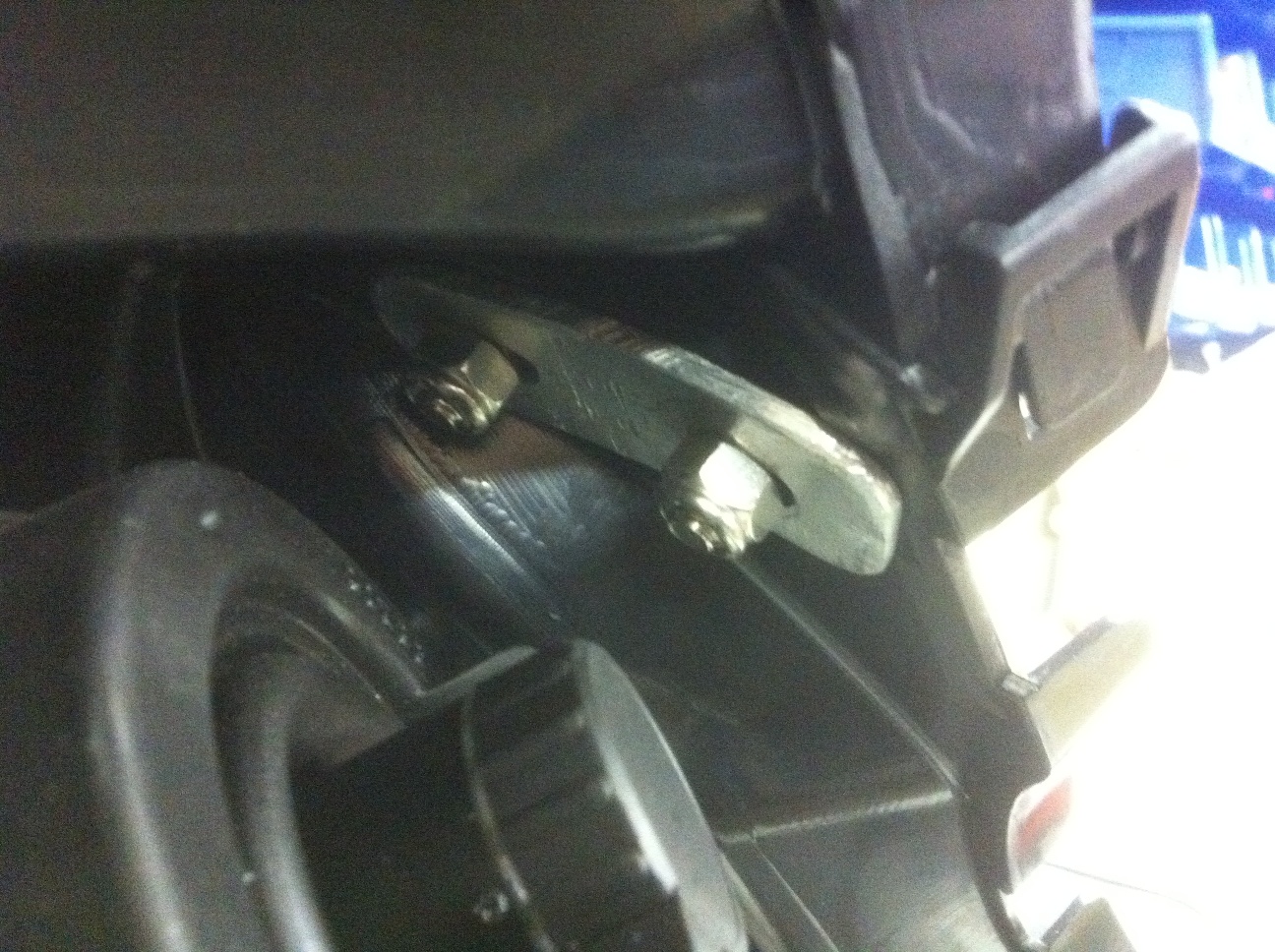

I like that setup. Is the plastic durable enough to mount the base to it without possibly cracking? Or did you put some washers behind it to reinforce? Also, how good is the display on the garmin 60 series? Waterproof?

Here is a pic of the backside of that installation, where I used a piece of aluminum as a backing plate (which is bent to match the shape of the plastic) with nylon locknuts. The other modification is to file the back of the ball-mount base, so that it matches-up to the curvature of the plastic panel. i have done two sleds like this, and after 2 seasons, everything is good as new.

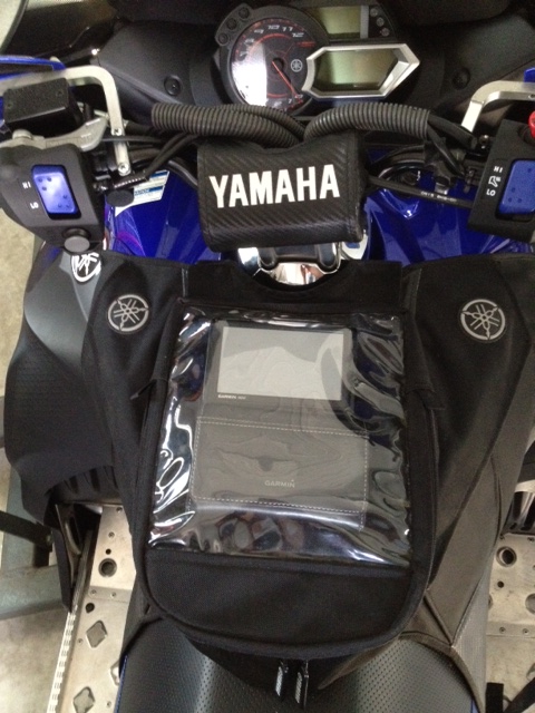

Im thinkin of getting a larger screen non waterproof nuvi and just putting it in my map/tank bag. I may not have touch screen functionality through the clear plastic of the map bag but thats not a big deal.

I never considered a tank bag. Good idea!
mr. shide
Yeah this is my 2nd apex i have had with a tank bag now. I really like having the extra storage. Plus it protects the plastic on the tank shroud. Now its a high tech digital map bag! Ha!

I use the same setup. My Spot Messenger , GPS, and cell all ride right there. Have 1on my 06 Attak and my 11 apex XTX. The side pockets and bag hold let's of stuff! I'm 6'3" and boon dock the Attak. Never interferes with my movement. The 11 is strictly a trail sled, and the bag again, never interferes.
