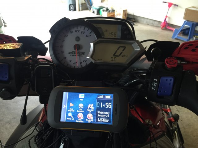

I wound up tapping my Lake Effect riser for a 1" ram ball to put my iPhone right in the center of the bars/riser below my speedo. I will be/have been using my iPhone with imotoneige and GPS Kit app. Its expensive but I wound up getting a LifeProof case and 2 belt clips and put a Ram diamond plate ball on one of the belt clips. Cool thing about the LifeProof case is I can do the same thing on the ATVs and wave runners and I can use the phone in the water/pool.
Also I can make collections of waypoints tracks or routes and put them in my Dropbox account and only load what I need in to GPS Kit for the day and easily share my data collections.

I gave up on the iPhone as my primary GPS largely due to battery life Limitation. The iPhone would last a max of 1/2 day on the wave runner while navigating and in cold conditions it would last even less even when charging. I went to a Garmin Montana 600 for the bigger screen and better processor but for sledding ATV ing and waverunners I would recommend a non touchscreen device. I had serious issues on the wave runner where I couldn't unlock the iphone to check my route on an open water crossing in rough waves due to the screen being covered in water. Once in a while snow would mistakenly register as a touch on my Montana screwing up my routing. I still use my phones location abilities for imotoneige in Quebec as a 2nd opinion on map discrepancy but the phone stays in my bibs to keep warm to preserve the battery and stream music.

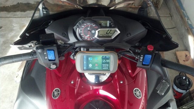

funny my photo of Montana 600 and photo by bcmsw are taken within 1 hour of each other.
