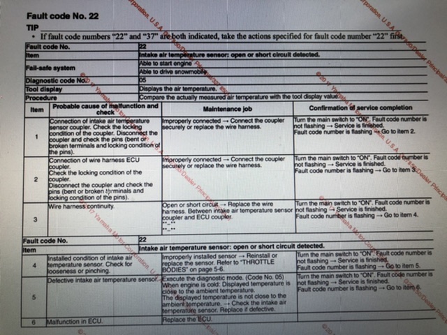

Muskrat, The noise you heard IS the gas tank venting. It is NOT an electronic gremlin. The vent has a valve that is made to hold pressure, when the tank warms up, the vapor expands and it vents and whistles. The exhaust and tunnel heats the tanks, it whistles when venting in or out.
Sit on the the seat and it pressures the tank, get off the seat and the pressure reduces and it quits venting. When the pressure is high enough it will vent. I'm telling you this is what you were hearing.
Code 22 is air intake temp sensor.
