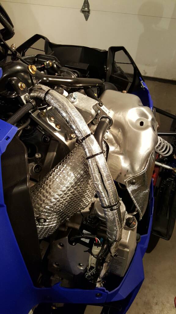

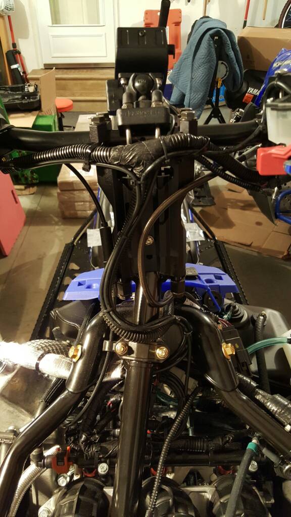

Finally finished wiring my hand guards. Wow are the leds bright. As I had said I would, I wired them direct without a switch. I bought an auxiliary connector and ran the wires down to spare accessory connector by the right foot well so I didn't have to slice anything. I also ran my Garmin amps GPS mount power to this same terminal. I got fiberglass heat resistant wiring protector that I ran all wiring inside to protect from heat in this area and the results look factory. I'm pretty happy with how it turned out. Any questions let me know.
