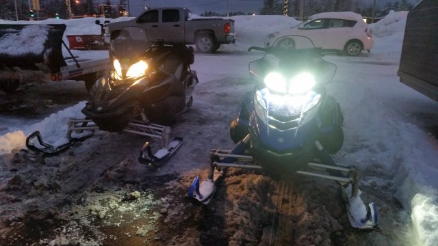

I purchased an H4 "Sirius LED" light kit for my 03 RX1 off ebay for $100. Each bulb is rated at 3200 lumen and the color is 6500kelvin. NOTE: This is not a custom made kit for any sled, however, the Install took me about 15min, no brackets or screws were involved, its all plug and play as well.. I mounted the ballasts using 3M tape that was provided.. When looking under my hood, it almost looks stock! The pic attached is of my buddies NEW 2013 Apex with 0.2 miles, we were about to hit the trails to break it in; I say this only because halogen bulbs, not always.., but sometimes loose there brightness,so here, this is not the case, theses bulbs are that BRIGHT! The stock Apex, RX1, and im sure many other sleds use the same set of "Phillips" 55watt halogen H4 type bulbs. These LEDs i am running only use 30watts on low and 38 on high, so not only can you see 70% better at night, your also easing the lode on your stator as well.. Pics are below. Questions comments or likes are always welcome!

Wow that is quite a difference. So they just go right into the oem bulb socket and then you just have to wire it up ? That was $100 for both lights ?

Yep $100 for the set... They mount right into your factory headlight socket, and there is absolutely no cutting or splicing of any wires, all plug-n-play.. The OEM lead connector that you would plug into your factory bulb simply plugs right into a connector lead coming off the ballast. The ballast/s that come with the kit has 2 more connectors, one lead goes to the LED and the other goes to the heat sink with the built in cooling fan.. NOTE: As of now..These are the brightest plug-n-play LED kits you can buy..

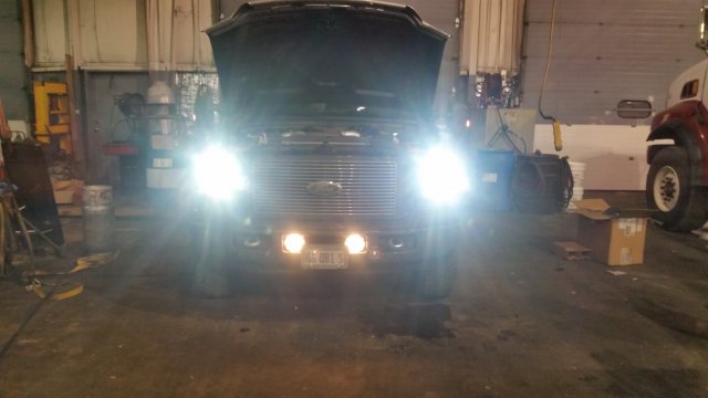

I was such a fan of this lights output on the trails and in the dark i purchased a set for my F-350! See the HUGE difference they make on my truck in the photo below..
Now i just need to get a pair for my fog lights

Both sides contain the same size CREE type led and are mounted to where the bottoms are constant, the tops kick in on high/brights, however, i don't think they get as bright as the lower ones do... When using the brights on the trails you can see the tops of the trees.. no joke! Not something you wanna be doing when riders are coming your way..Very nice. They look similar to my HID's when compared to the stock candles Yamaha calls headlights.

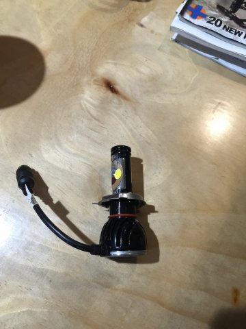

I couldn't agree more, the market is flooded with them.. i am a huge fan of led flashlights and lighting but imo none of the headlight replacement bulbs were worth the money until I seen these. I mean no disrespect, but look at the LED size and that bright 6500k color differance compared to yours. Yours look like 4300k which is nice as well. I just prefer that brighter white with a tint of blue look, but up until I found these the only way you would get that color was with an HID bulb..View attachment 105946 View attachment 105945 Tons of LED's on the market now. Got these from Royal Distributing for my Phazer. View attachment 105940View attachment 105941
