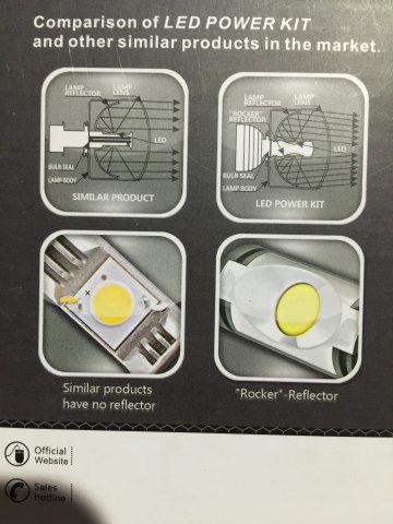

Wow...I think i will tape a piece of tin-foil around my LED..Then maybe the guy around the corner will see me coming because my distance is way off!View attachment 105994 I used common sense and tested both. My little LED's have a reflector built around each Led. The ones you have are old tech now.

So these two pictures show the problem with putting LED or HID's into housings meant for filament bulbs. (not picking on you guys, just used your pics as references!) You aren't getting more light on the road. You are just creating a ton of glare for other people... Dropping in one of those bulbs into a road vehicle is actually illegal, just rarely enforced unfortunately. REAL HID or LED lights have an extremely sharp cutoff, laser sharp. Good lights in the two examples below would be 1/10th as bright from the position of the photographer.
(note, the LED's sx7001 is talking about are slightly better, but still a poor match for an incandescent housing.)

.. My RX1 on the other hand is actually distributing the light wonderfully..! All of the pictures i took from the front of my sled were taken with my phone, so they really aren't doing any justice. The headlights look bright unpleasant to stare at from the pictures, however, when standing in front of my sled between 0-20 feet away, it looks like a glowing fluorescent bulb.. and i know this has to to do with the LEDs design, the low beam is in the downwards position. I posted snapshots i clipped from a video off my GoPro. If you look at the pictures you will see how the light is clearly.. on the ground.. and possibly 3x-5x brighter than factory as well..! So i am clueless as to why you would said, "You aren't getting more light on the road. You are just creating a ton of glare for other people..."? In your poorly answered and misleading comment you state, "REAL HID or LED lights have an extremely sharp cutoff, laser sharp." There are several car manufacturers that installed HID lights in a housing that was was designed for both Halogen and HID bulbs and DO NOT have an extremely sharp cut off.. (Example: 2004 Lincoln Aviator w/HID) at all..! The only.... and absolute ONLY way to produce that kind of beam is with "PROJECTORS" which you have failed to mention.. So how and why did you say, " (note, the LED's sx7001 is talking about are slightly better, but still a poor match for an incandescent housing.)" He said, "the pattern and distance suck"..?
