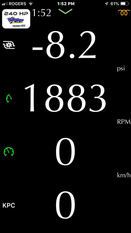

View attachment 143911 Ok got my flasher from Hurricane thanks to Marc awesome tool. It’s all working mint and tried txt you Yamamarc and not going threw

If that your screen shot , you have the wrong flash for what bar map sensor u have .View attachment 143911 Ok got my flasher from Hurricane thanks to Marc awesome tool. It’s all working mint and tried txt you Yamamarc and not going threw

It should never read -8 psig

I've had negative psi numbers at idle on all 3 of my turbo sleds, all 3 different setups/different tuners????It should never read -8 psig

My turbo viper.read negative at idle pretty sure it's normal!!

My sled read negative boost after I installed the TS BOV and 3 bar sensor until Ben updated my tunes to read the better sensor. Did not ride it so no idea what the effect would be.

That’s normal a map sensor reads vacuum as well as psi on turbo there are 2 settings. Just to clarify if you look turbo psi and map psi. This is in settings when you pick your option. See change setting to turbo psiIt should never read -8 psig

Good to know Thanks!!
