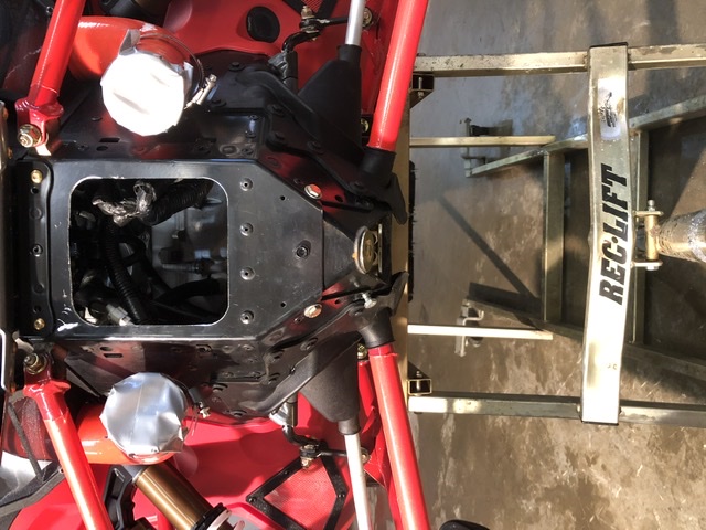

A few frog skins in the panel above the cooler would allow alot of air in
Not really, been there done that with a huge hole and frogskinz right behind the stock cooler, didn't do much to cool the stock cooler...
Dam pic is sideways again.
Anyway, I have enough vents in the front and back of this thing to feed a jet turbine.

Yes sir but she has to look prettyA few frog skins in the panel above the cooler would allow alot of air in
I dont want hood to look like #*$&@
NYTurbo
- Sep 26, 2017
- 1,568
- 1,373
- 958
- Ottawa
- Sidewinder
You can see it unless you lay down and look up or take your hood off.Yes sir but she has to look pretty
yamamarc
- Sep 29, 2013
- 3,051
- 2,848
- Massey Ontario
- 2019 zr9000 Ltd
I meant putting vent on the hood itself just below headlight above the secondary intercoolerYou can see it unless you lay down and look up or take your hood off.
