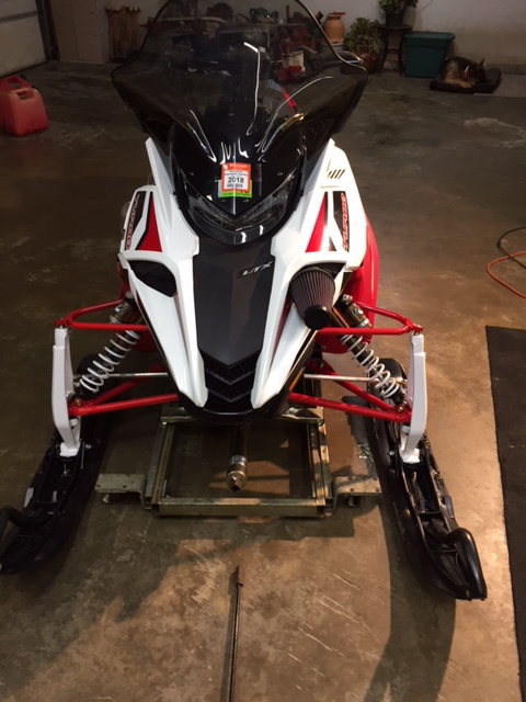

Mike, any results yet? Also wondering if you have a few photos close up of it going through the screen and what its looks like behind the screen, etc.My solution to getting actual ambient cold air in to the intake. Water resistant Outerwears sock is ordered as I know it will be needed for snow usage. I hate the fact its outside the hood, but I'll order up a new factory screen that has to have a hole put in it so very easy to go back to stock, no need to put holes in hoods that is irreversible or anything like that. If I don't like it, I can go back easy enough.
Reminds me of the filters that stuck out from the side of the old Cat Suzuki 1100 turbos between the a-arms on the clutch side.
I just had to ad on to the inlet tube with a silicone coupler and length of formed and curved alum tube, then put a hole thru the factory screen. If it adds power or makes it more consistent, which I believe it will do both, I'm all for it. Its not a beauty contest after all.
Thanks!
Art, Its back under the hood where it was. With it hanging out of the hood, it went leaner than I'd like to see it. I need to do more testing with it next season, but it does draw clean, fresh cool air.

Ah. Maybe once GAP releases the fine tuning mode and we can add fuel for changes like that - will be a super powerful feature. Keep us posted.Art, Its back under the hood where it was. With it hanging out of the hood, it went leaner than I'd like to see it. I need to do more testing with it next season, but it does draw clean, fresh cool air.
I wonder if the mountain guys that have them sticking out the hoods are finding lean issues or possibly because the air gets so thin up there they don't have any issues. Would have been nice if Yamaha went mass-air instead of speed-density, but that would have come with more cost.
