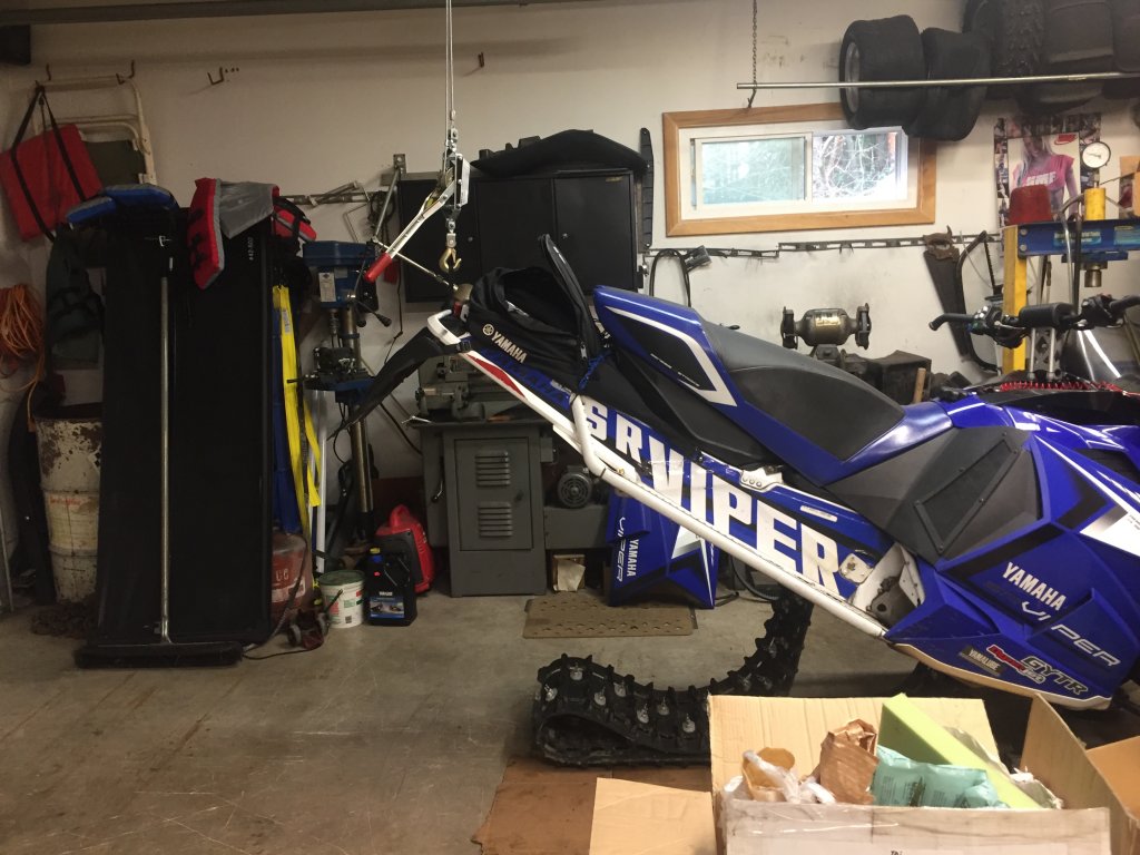

What has worked for me, is to drop the back end of the skid out very far until you can engage the forks on the front torque arm on the cross shaft. Then rotate the rear end of the skid up into the tunnel. With this method, the back end of the skid will be out of the tunnel by a lot - a few feet. I have the back end of my sled hanging from the ceiling in my shop using a chain hoist so I can lift it quite high. Others may have a different or better method.

If you bring the skid in on such an angle how hard is it to stretch the track around the rear rollers, cause its gonna be tight.
Do you just work it through one wheel at a time?

I found that the height of the rear is a big deal. Everyone told me to get it real high and I was struggling like you. I lowered it some and then it was easier to get up there. I had the springs unsprung (not a real word) as well so it is collapsed.
Both these guys are right. The skid honestly falls right out at a certain hieght even without loosening track tension or collapsing springs. I just keep raising it till that happens. When putting it in you want to go right to that point or slightly lower. Collapse rear springs. Loosen track tension all the way and Use cardboard between track and skid. This all helps but key is to hook one side at a time pushing back of skid and track to side to accomplish. Then carefully lower sled without it falling out. This is how high it needs to be.

I gather you begin to move the skid into the tunnel on an angle and get one arm slung on the cross shaft? then toggle the back in, to get the other arm on the cross shaft?
