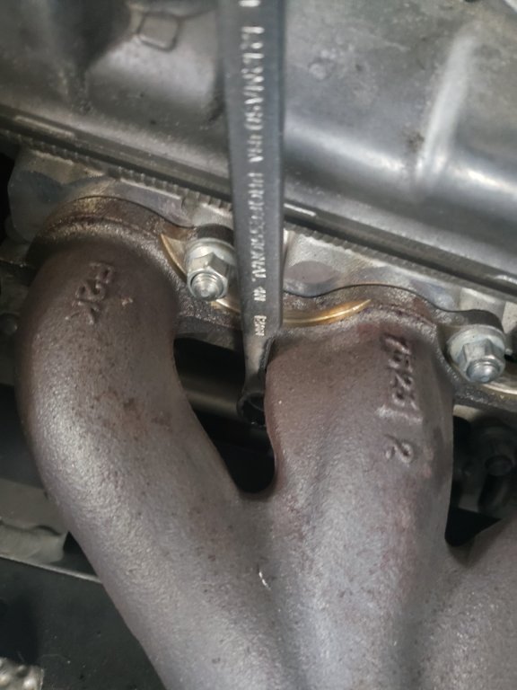

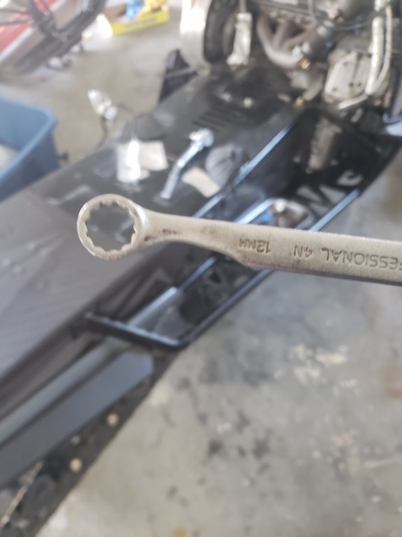

When you are removing the stock exhaust manifold you will need either a 12mm (preferably 12 point) 1/4 drive flex socket to remove the lower center pipe flange bolt.
If you don't have one you can grind down a 12mm 12 point wrench to fit see pics

very smart to grind away wrench, I never would have thought of that..thanks for sharing and teaching. Joe

I have a set (6point) but wasn't enough room to crack the bolt loose!! I would need to get a 12 point and tryThese work good too and are great to have around. $16 from HF
View attachment 156711 View attachment 156710
Great idea, as it is hard to get to. I removed secondary clutch, slid my hand under jackshaft, and put wrench from underneath.

Holly crap...lol you must have small hands??Great idea, as it is hard to get to. I removed secondary clutch, slid my hand under jackshaft, and put wrench from underneath.
I looked at mine today while installing closed loop and there is no way my gorilla hands would fit in there!!
