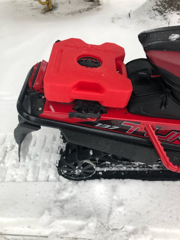

I have Kimpex Connect with Rotopax gas caddy and Adventure tunnel bag which can mount either to the tunnel or stack up on the caddy on Sidewinder.Has anyone used the Kimpex connect system on a Sidewinder?
I am looking at options for storage/fuel on longer trips and am wondering if this system or the Whiteout Tech system would better suit my needs.
I have an xtra set of bases which I used the xtra set of plastic pads from to provide enough clearance from taillight.
A big plus with Kimpex is the ability to put a padlock to secure to sled, and factory 20” bag still works, just need to hold down the very rear of bag when attaching gas caddy

If holes are drilled other than where marked for the Procross chassis what ya are doing is setting for either Ski Doo or PolarisView attachment 170875View attachment 170876View attachment 170877View attachment 170878

I’m not sure but all I’m saying is to check before you drill, I can’t remember the exact spacing of the holes on the template but if I used the template I got with the kit my bag or tank would be lose on the brackets once mounted.If holes are drilled other than where marked for the Procross chassis what ya are doing is setting for either Ski Doo or Polaris
Yamascotty
Gas can holder and adventure bag have several different holes to fit whether mounting to Polaris, Ski Doo or yamacatI’m not sure but all I’m saying is to check before you drill, I can’t remember the exact spacing of the holes on the template but if I used the template I got with the kit my bag or tank would be lose on the brackets once mounted.
For Sidewinder Viper or Tcat drill holes in tunnel according to paper template and figure out which bolt holes on gas caddy or which screw holes on Adventure tunnel bag are correct
