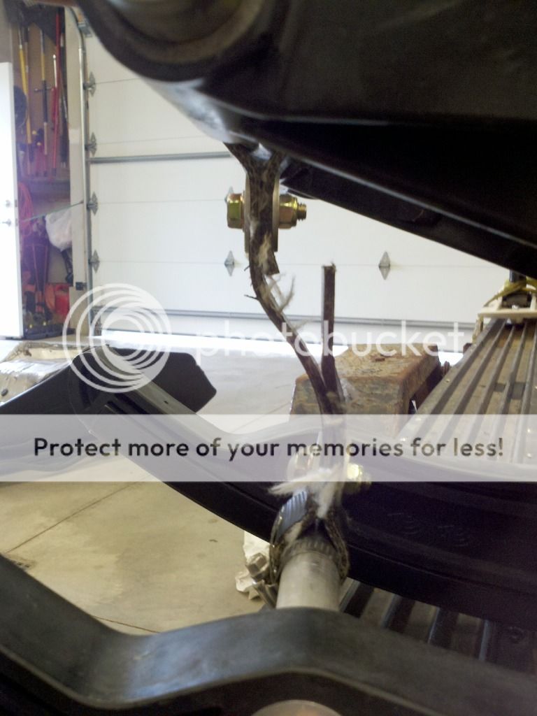

Because this is a 151" now the manual for the ZX2 is really CLEAR they want you running the limiter strap short...why? Dont know but I set it per the manual on the tightest setting:
Finished 151" ZX2!

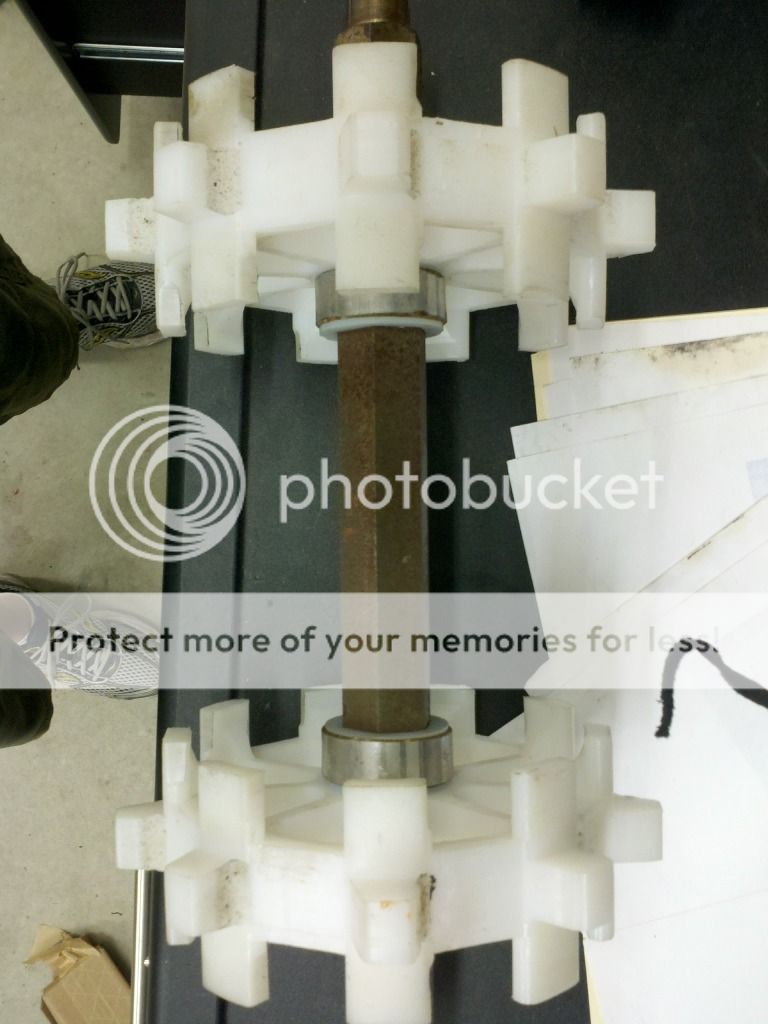

Next I swapped the track and checked out the condition of my AVID drivers they look new after 1000 miles they wear really nice!

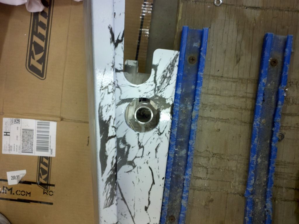

Next up was the Hartman 151" tunnel extension. I was hoping this was going to be the easiest part of the job it was not. I bought a custom U cooler over on snow west for what I thought was cheap and wanted to use that. Well it was NOT going to fit in the stock holes with out butchering the cast aluminum exhaust cradle and even then the u cooler wouldn't sit flush to the top of the extension and Im sure would fail at some point. So I pulled the U cooler back and drilled new 1.5"D holes in the extension (painful to do if I screwed up I was in trouble LOL)
No you can see the u cooler hose ends line up with the holes. I had to keep it as far foward as I could so still have the stock side covers hide the rubber pipe.

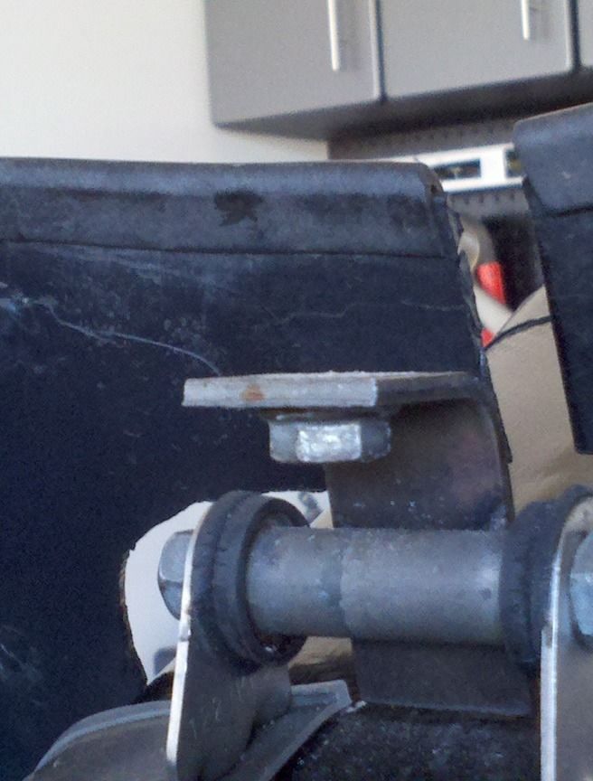

So those had to be trimmed, I probably weakend them a little but I figured out a way to add material in later to make up for the notch
Final U cooler mount:
The pictures make it look like the hose is going to hit the top of the hole I drilled but the hose ends of the U cooler are angled and the hose sits flush in the middle of the hole.

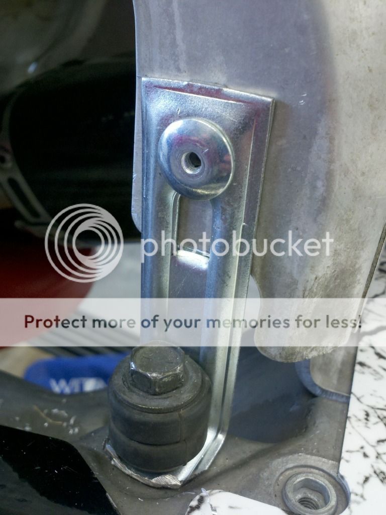

Next was securing the rear of the heat shield now that there was no 30lb boat anchor to bolt it to. There were "L" tabs on the heat shield for marking the height but I couldn't get to them after the tunnel extension to remove any bolts. So I decided to fab up some brackets I found in the parts bin and bolted them where the old muffler used to sit:
You can see on the inside there was a little 'finger' that supported the shield and the rivet bears no load it just holds things in place:
Another thing I found after I was all done was the shield was rattling? WTF everything was tight and after careful inspection I found the rivets included in the hartman kit that I used all had loose mandrels in them! I have never seen this before in a rivet it basically pulled the outer shell tight then left the madrel in to be all loose. So out came some JB weld and I covered the rivet inside with it to keep the madrel from vibrating. All quiet now!
