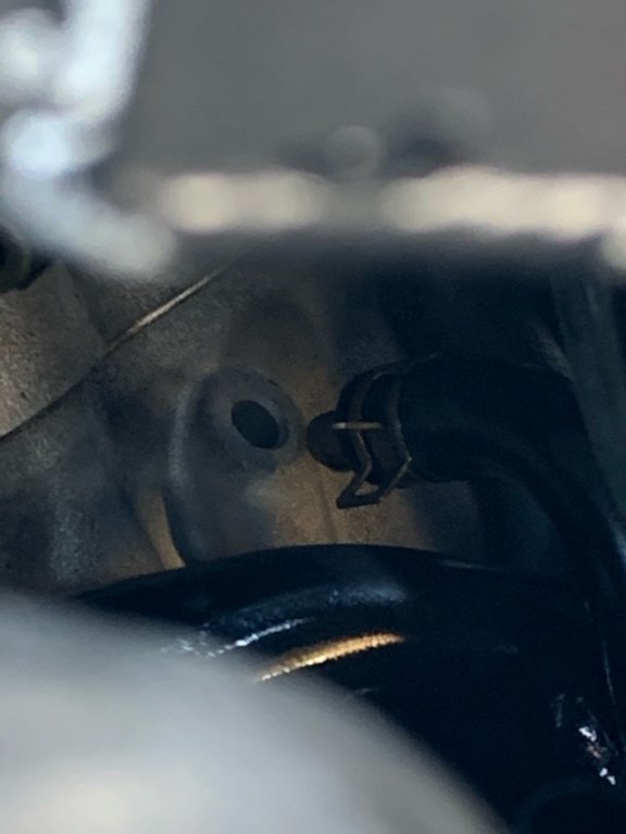

I can’t win!!! 4 miles in:

aw dang it! epoxy that mf back in and try again unless you plan on tapping the hole for a barbed fitting.

I don’t think I like the idea of tapping my brand new block and have a metal shavings get in there. How much pressure is in the coolant system anyway, I thought it was less than 15 psi. What a jip!!!!

supposed to be less than 15.

Where on the engine is that hose fitting?

you could pressurize the cooling system with like 5lb of pressure while tapping it so it blows the shavings out of the hole if they do not have an oversize fitting/pipe you can put in there.

Its right under the TBs in the center of the block. I don't even understand its purpose...Well atleast you can Plan a trip. We are still the level Red Covid restrictions. Nothing is open to even plan a multi day ride.

From research I found that permatex makes a product for this. It looks to be perfect.
Followed their instructions to a T which included this prep cleaner:
Then used a Q tip and cleaned up the hole in the block.
Then added the retaining compound and done!

It is alive and leak free!!!! Woooooohoooooo!

on start up I had a coolant leak from right below the T stat housing, the house that goes to the oil cooler. It was a hole and i was able to push it up on the barb more and get behind the barb. It dripped into the protective sheath around that hose, then trickled ALL the way down to the heat exchanger. Took awhile to find but easy fix!
