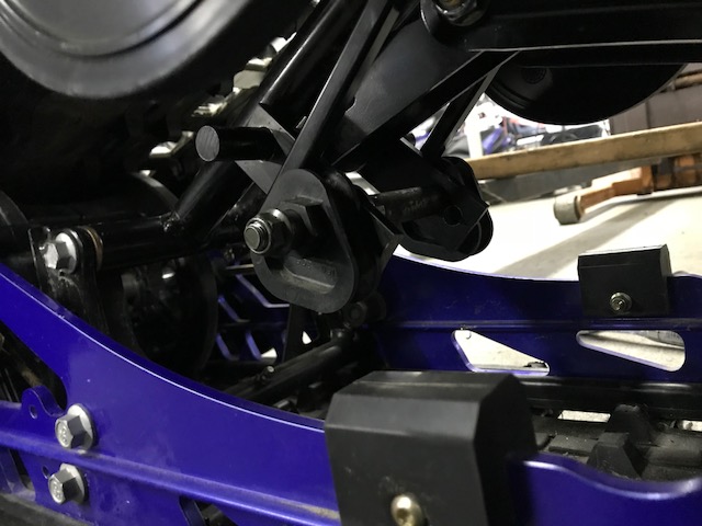

We put 500 miles last week on my prototype relocate that we installed on my buddy's 14 ltx. It performed flawelessly for him at 140 lbs. He was running the blocks on the Soft setting. Once I get caught up on getting orders out I'm going to give the kit a good look over to see for sure that there are no issues after the ride.
I did run the relocate on my 17 winder ltx dx for one day. I had it on the H setting, but it was too soft for me at 200-210 geared up. I'd say the relocate is going to be ideal for the 190 and under riders.

Did you ever get this done to point you could sell a fewHere’s a peak at what I’ve been working at. Basically its a bolt on linkage kit that relocates the adjuster blocks to reduce preload. No drilling, welding, bending...just bolt it in! Have a 140 and 165 rider coming over saturday to do some sit in measurements with the prototype.
You can’t expect a sled to transfer if its too stiff to yield propper sag.
