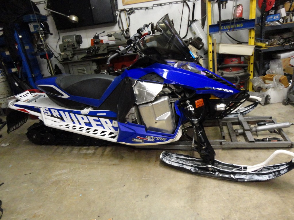

More wraps on the spring and diameter is .375” compared to .400”......Hygear is definitely softer/less rate. But the angle could be different (preload).
I think they bought out the cat supply of the Silver springs in my picture. Wish I would have thought of that but was not happy with that spring. Not enough free sag. Even bent for me.More wraps on the spring and diameter is .375” compared to .400”......Hygear is definitely softer/less rate. But the angle could be different (preload).

The stock mounting point for the triangle torsion adjust block is the round metal rod seen in the photo. Below that is the added parts that are lower and more forward releasing some of the preload tension of the torsion spring. Another whydidntithinkathat from Travis!Can you draw a arrow to the part you made,so it is a little more clear. Thanks
lol but I did..lol but where Travis expanded was the varying holes and expanded range...NICE!

Thanks brother,i was feeling it was the round plug and plate,but just not sure.The stock mounting point for the triangle torsion adjust block is the round metal rod seen in the photo. Below that is the added parts that are lower and more forward releasing some of the preload tension of the torsion spring. Another whydidntithinkathat from Travis!

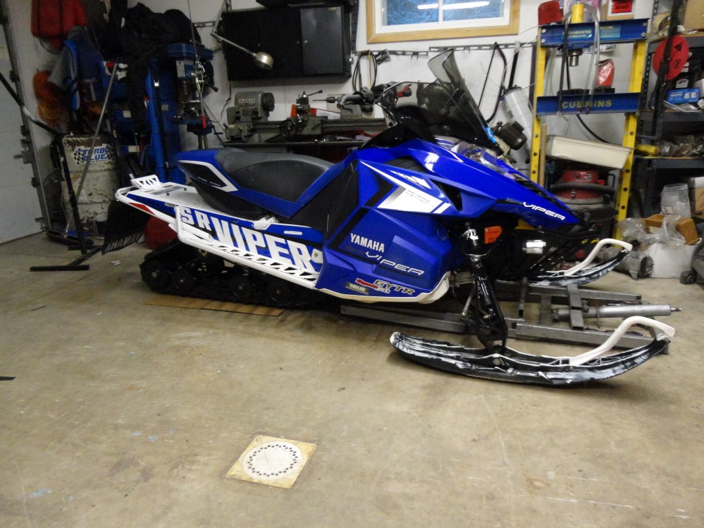

OK removed 1 spring. Only one engaged is the lighter LTX spring everyone has. This is how it should be.
This is with the second spring engaged and bouncing up and down again. No free sag. Sucks!

There ya go. Just take 1 off!

I still believe that arm move is necessary for what I need. Its hard to explain but Phazer and all 13 Cats had it. I am talking sag caused by the geometry. Absolutely no spring felt within that sag. Most call it slop. I call it ZPS. Differance is when you do start to feel the spring its hard,stiff. Ideally this happens just a hair before the arm hits transfer blocks. Hbishmans adjuster will definitly help get to that point.There ya go. Just take 1 off!
