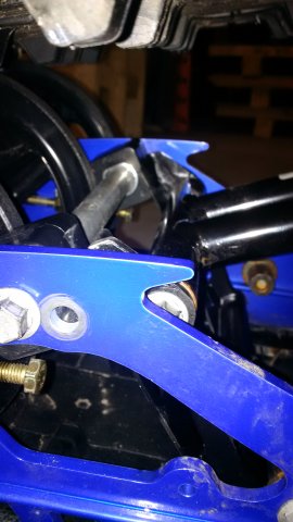

The pieces that u welded on the moveable arm, did u weld those right on top of the flat spots that are already there are did u just add a piece to the top part?
hellflyer
- Dec 2, 2008
- 1,085
- 687
- Georgtown ONT. Canada
- 2020 sidewinder ltx se
I added to the end, about 5/8"

I don't see any studs in the photos.View attachment 117826 View attachment 117825 Oh some pics!
