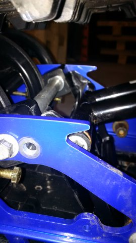

OK! Had some time this afternoon and the shop to myself and went for it! Took 1 1/2hour even though I jammed my mig welder part way through. I removed the outer wheels,spring tension then lower link and transfer shaft. I had al the same thickness metal so cut it out and welded a 1/2" extention on the lower link. With the block on the shaft on the lowest setting I get about 3-4" more ski lift. Only mod to the rails was drilling another hole.:-o
Oh some pics!
Well! The lower link pivots and stops at the block, if you just move the shaft back the lower arm will pas the shaft on compression. I added 1/2" to the arm. I put a white line in This picture where I added.

It definetly lifts the front end higher by 3-4" before it stops now. That's with the track flat on the ground and lifting from the front bumper with my forklift.
