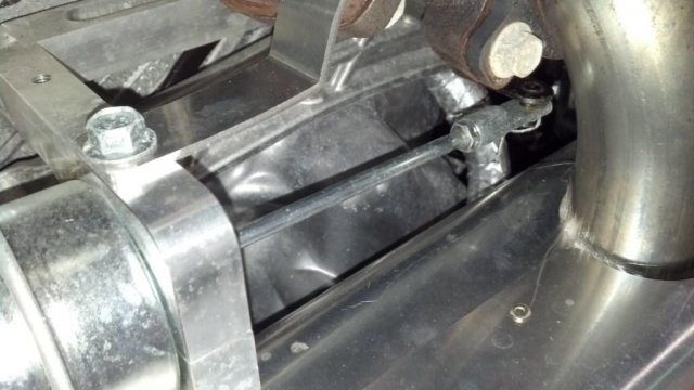

So I want to lengthen the rod to reduce psi, but how much do I lengthen?
Well on the waste gate on my MPI I think 1 turn was about 1/2 lb of boost I would go 2 turns its quick and take it for a test ride
Last time I did mine I was adding 1.5#'s of boost and I had to remove the jamb nut from the rod to have enough thread to go 3 turns. the pic is before I made the adjustment and I was going from the 4.5 to 6 and it once on WOT hit 7 so I back it out 1/2 turn.

Yes turn down the boost if you are running stock injectors with stock fuel pump 7 is very very bad!!!

Back the boost off several turns then start working upwards 1 turn at a time until you get close then 1/2 turn increments. Keep it low until you get good AFR gauge.

The bung is after the turbo. I took the O2 sensor out and turned the key.. it went full lean. I then installed it and it was normal again.. I also had a couple loose bolts in the exhaust... and maybe a loose connection. Whatever it was its fixed now. To turn down the boost ill have to remove the turbo from the sled right?

Ok, so I have to take the turbo off which is a huge nuisance. I took the cotter pin out and turned the threaded end piece on the rod counter clockwise 1 full turn. It still shows 7 Psi everynow and then and bangs off the rev limiter. Im going to try 1 1/2 turns next.

Hey guys. I've loosened the rod out 4.5 turns now. And I'm still over boosting.. I took her out on the trail tonight and I'm sure I seen 8 flash on the gauge.. I immediately turned around and went home. I don't understand why there is so much tuning with a "kit" Shouldn't it come set up, or pretty close to what you need.. I'm going to do another 3 turns tomorrow, but I'm worried that I'm running out of threads.

You have altitude compensation on MCX, @ 2000 feet you should see ~ 7.3 psi.
So set your wg rod as it was and look for solution for the over rev in clutches.
