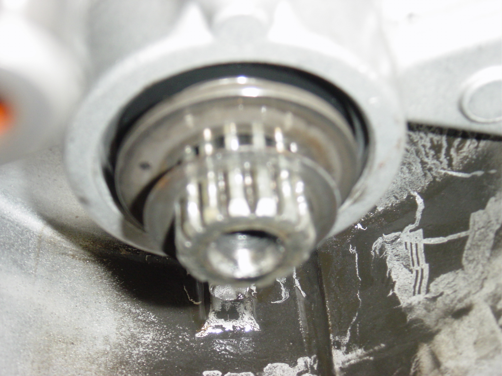

Well, i have gotten pretty good at taking apart the chaincase and putting it back together, but i would like to double check the placement of 2 shims and the position of a certian metal spacer. The parts that i talk about are on the part of the front drive that comes though the chaincase..once the shaft is sticking though the inner side of the chaincase, i beleive the placement goes: black thin shim, spacer with smaller side inboard, then white color, slightly thicker shim. Here are some pictures. NOTE: in the pictures the order of the shims is reversed. Picture shows the black one on the outside when it should be on the inside.

If anyone can help, i'd appreciate it, i am wanting to get the sled together tonight!

I have the manaul at home also and the placement is unclear even with that. After talking to Skydog, we think that the thicker, shiny spacer goes behind the brake disc. Still leaves the thinner one at question. If i can get a sceenshot of the manual, i will do so and post it.

Check the yamaha parts page... good diagrams.
Travis Moore
Here is a screenshot of the service manual..and the spacers i am talking about are NOT number 12, 28, 21, or 23. Also, the spacers around number 16 are on each side of the chain tensioner roller.
