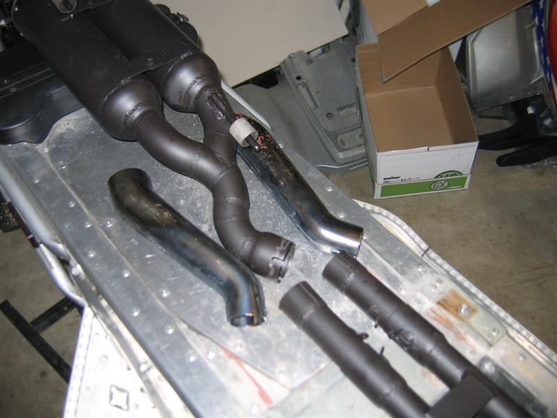

Time for the cutting to begin!As you know I have a bet that with tuning the true duals(right to head)will outperform the single which did beat both true duals and fake duals.Here is some more pics of all 3 systems.Shame to cutup the fake duals to make them true but I dont like all the bends anyway.

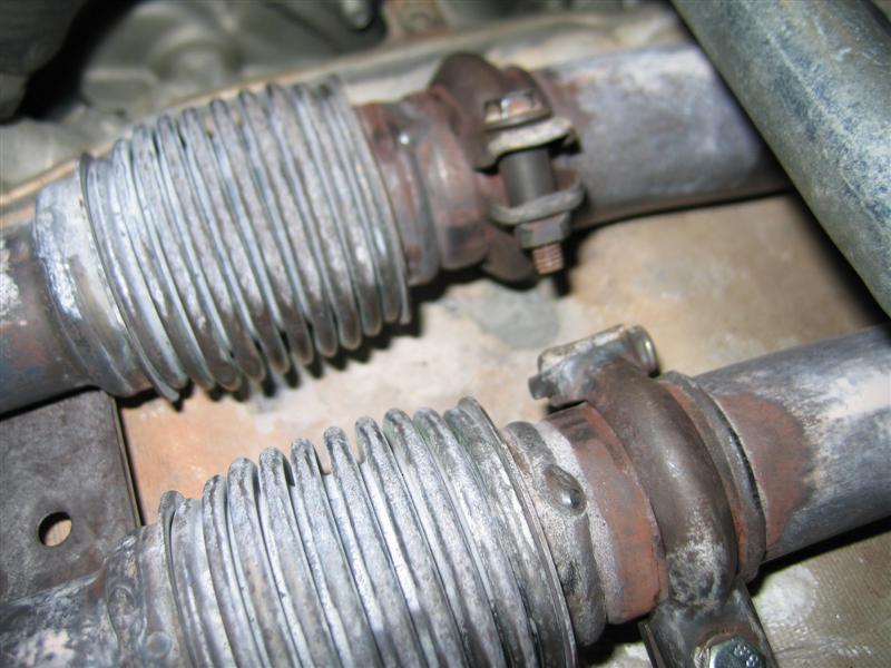

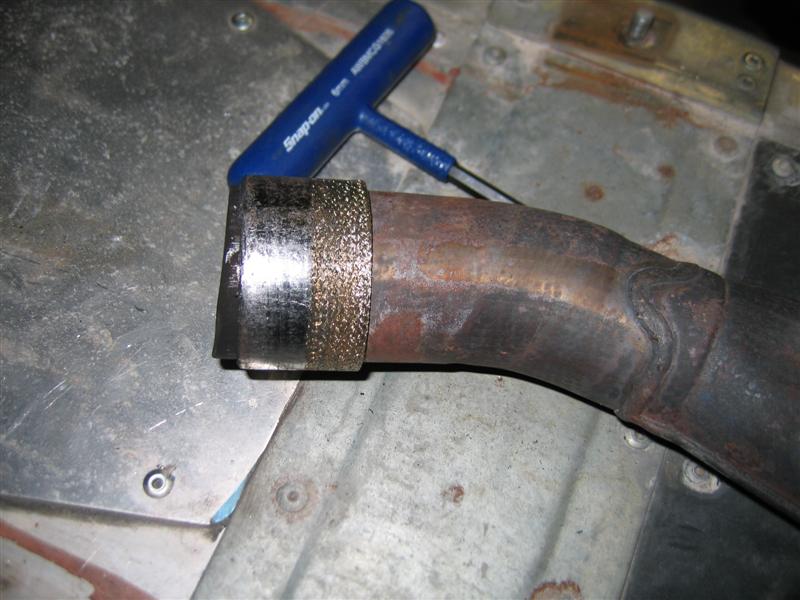

Notice the braided material he uses for stock headpipe where it is cut and new pipe slid on.It is something I never saw before and looks just like our donuts once tightened and squished.Almost like lead.

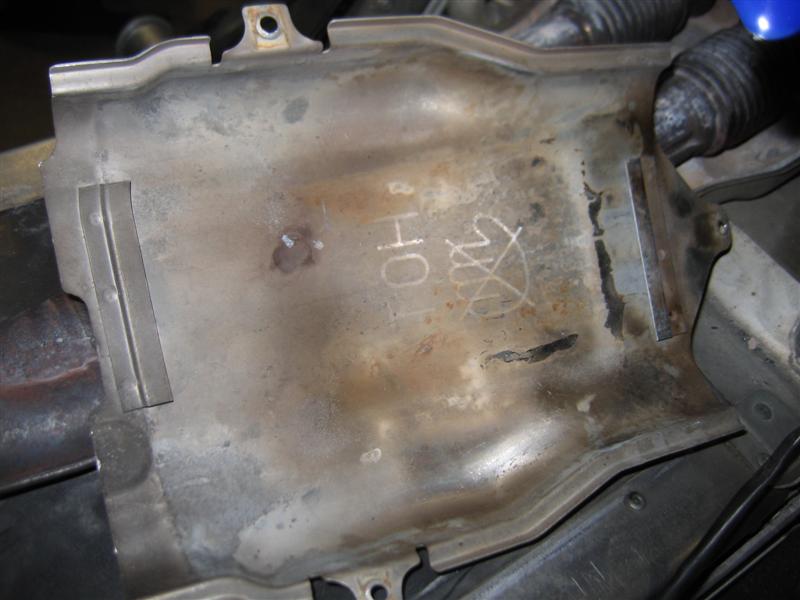

Guys take a look at your heatshields.Mine the fibre is completely gone on top and falling out on bottom.That is definitly a fire hazard and needs to be replaced right away.Looks like after 2 seasons the manifolds which were tig welded after cracking off are holding perfectly.Notice the weld on outside.Stockers were only on inside.Boy I am excited for this year.

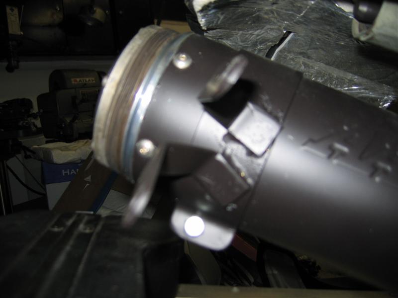

I couldnt cut the fake duals up.They just sound way to cool to do that.So I am going to buy some more silencers from Aaen for the duals.So here is some Pics and sound clips of single.The Supertrap discs do work on it.Also show where you cut stock header.I previously had another make exhaust so I would say if you had one within a inch of this cut it would still work.Also notice how the bracket for the stock exhaust guard is moveable.That is kind of nice since you can really position this exhaust well without putting pressure on anything else.
