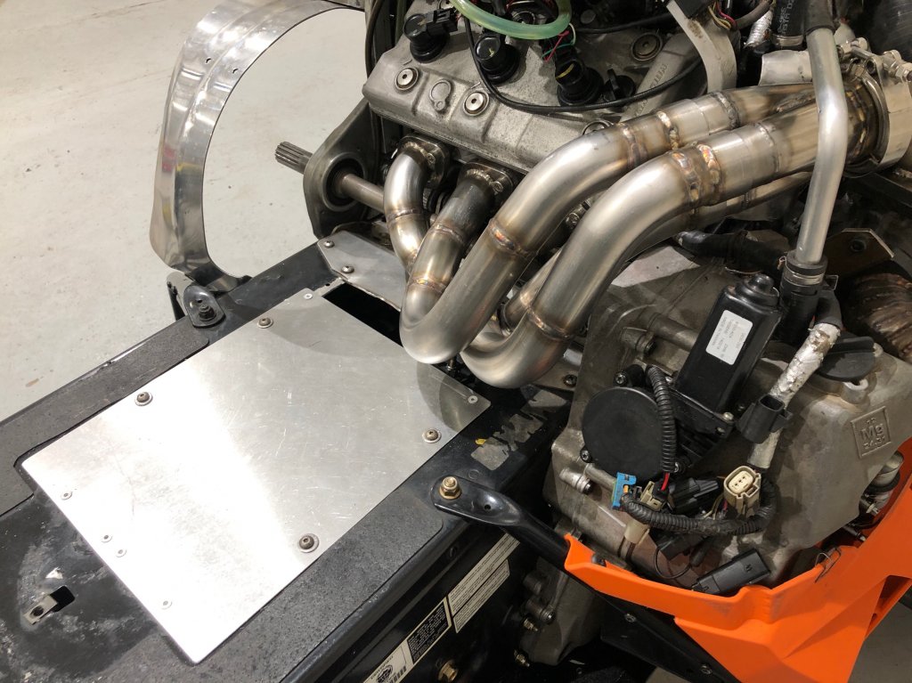

Make your own header that way your in charge of the quality control department

nice jobView attachment 155768
Make your own header that way your in charge of the quality control department![]()

the td header is a nice fit and clears the gas tank , I ran the header and 3 inch muffler from td last season and liked it ,
