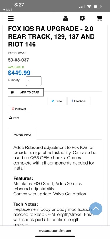

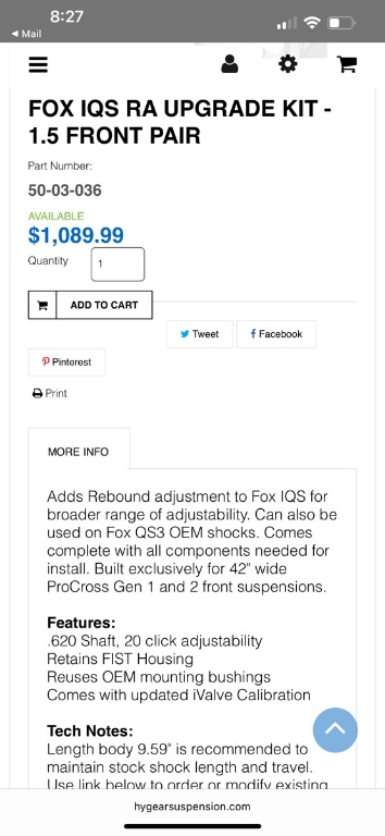

looks like my wallet might be taking another beating....

Beat me to it stain.
Been looking for this option for quite some time. Adding rebound to the tcat should.certainly help with the mid day moguls.that have been ever present for the last few years.
Wonder what the cost is, probably not cheap knowing hygear but it will be good.

I just emailed them on more info and pricing on this kit

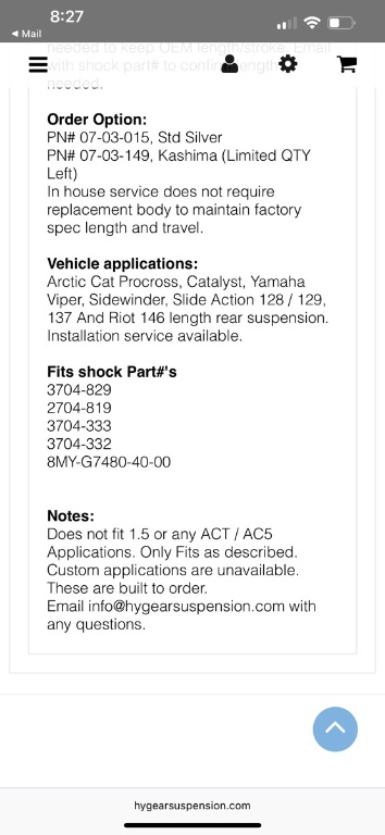

I think you’d be better off buying new QS3Rs and putting the servo on it and revalved at least you could put the manual changer in the old shocks and sell them. I think you have to buy the shock body you want on top of that price, that parts a little confusing
