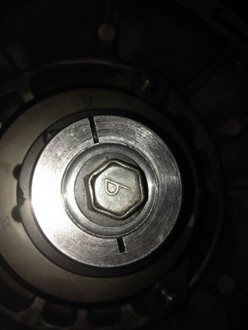

Is the stock bolt being used? Mine the flange head of bolt does not fit? But thanks for getting it here so quick.

My stock bolt went right in. Stupid question but you did take off the washer right?
Yes. No biggie probably a bit big bolt.
lt.
lt.
Now for the good news. See this plate that is no longer being used? Remove it and you just gained more than enough adjustment even for a well worn 8DN belt without machining anything. Tell me if I am wrong?

just sand the flange edge on sander take of .05 must be some differences in bolts, I use a stock bolt for testing fit... she was close but fit...
Yes no biggie. What do you think about removing the contact plate to gain adjustment?
