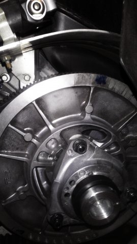

View attachment 100343 View attachment 100344 Works great on Viper plenty of adjustment with 8dn or 8jp. Need heat to remove the screws but should be good to go with no machining and ulmers secondary spring.

Well I installed mine tonight. Took the 3 bolts out of the back of secondary slid clutch back on put the bolt through the OSP adjuster and tightened up with a drop of locktite and un screwed the lock nut adjuster out to the end till the belt is at the top and deflection looked about right. I started the motor and tapped throttle to just barely engage clutch than shut motor off kept turning adjuster nut and restart motor and repeating until I got the belt right.

That pic is my viper with a 8dn on there which has 1000 mi on it. It is set with no deflection and still has plenty of room for adjusting. I see no reason that 3000 mi or more can't be achieved with proper deflection and same belt. Still plan to try Gates,8jp and a Ultimax but no reason to remove secondary anymore to adjust for length differences in all 4 belts. That and the saving of machining pretty much pays for the adjuster.
I would say if picky every 1500 or so. We will see about 8jp. With stock and original Ulmer clutching 8jp needed it every 500 mi. That may change with Ulmers new non binding secondary spring.With the 8DN belt and the "no belt dust" clutching just how often will a guy be adjusting deflection?
