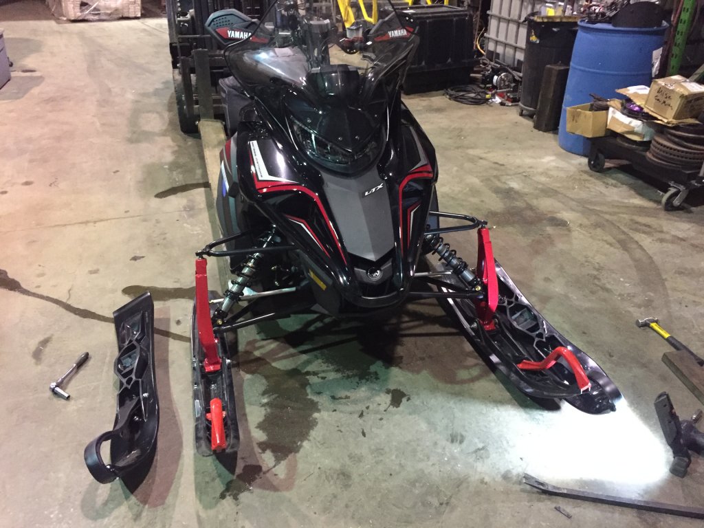

Thanks well I thought I would have them on by now but I have been fighting trying to get the bolt through on both skis for the last hour. I can get it as close as a 1/8" but still can't get the bolt to pins through to the other side of the skiYou got them mounted?

I let the weight of the sled sit on the ski. Then I used a crowbar to manipulate the ski to get the bolt in.
THanks I got it crown bar wouldn't work but used a clamp on one side and got it

did mine myself, use weight of sled, place blocking under inside edge of ski to help put pressure there, put drift pin through from inside to line everything up, large phillips works, put bolt in from outside pulling out phillips as you go, then had to pry up slightly at edge with the last bushing to get bolt through, used hook end of crowbar.

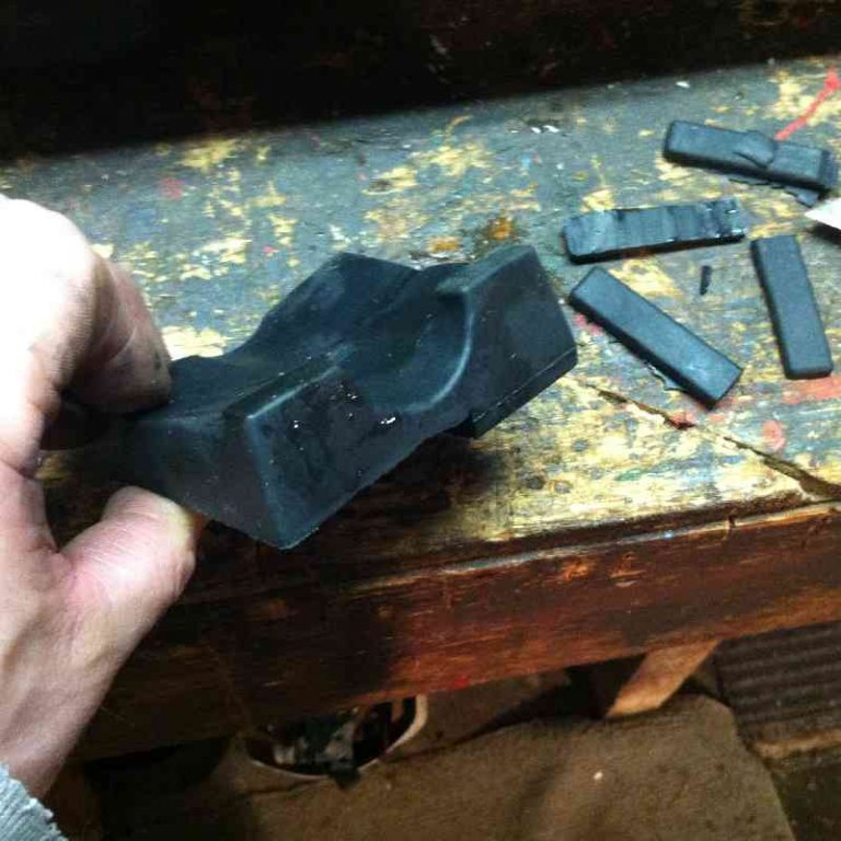

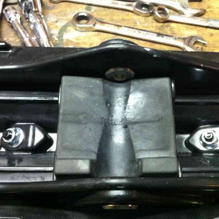

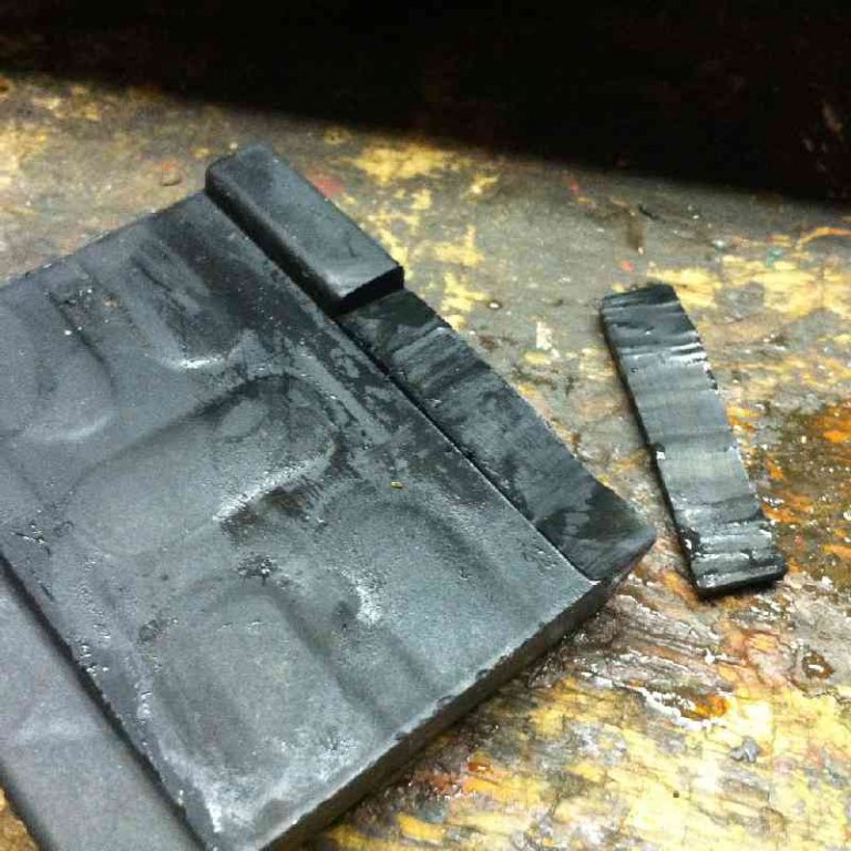

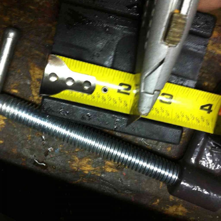

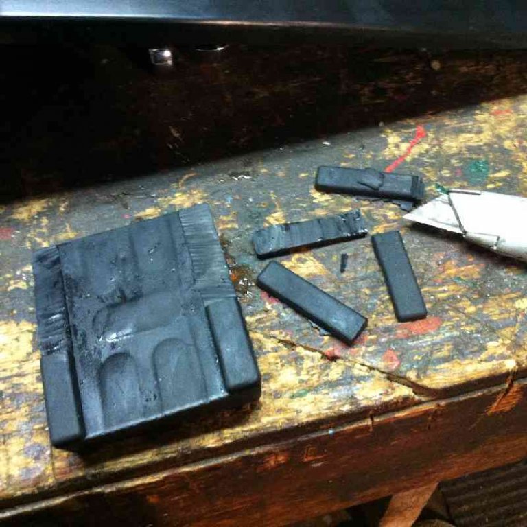

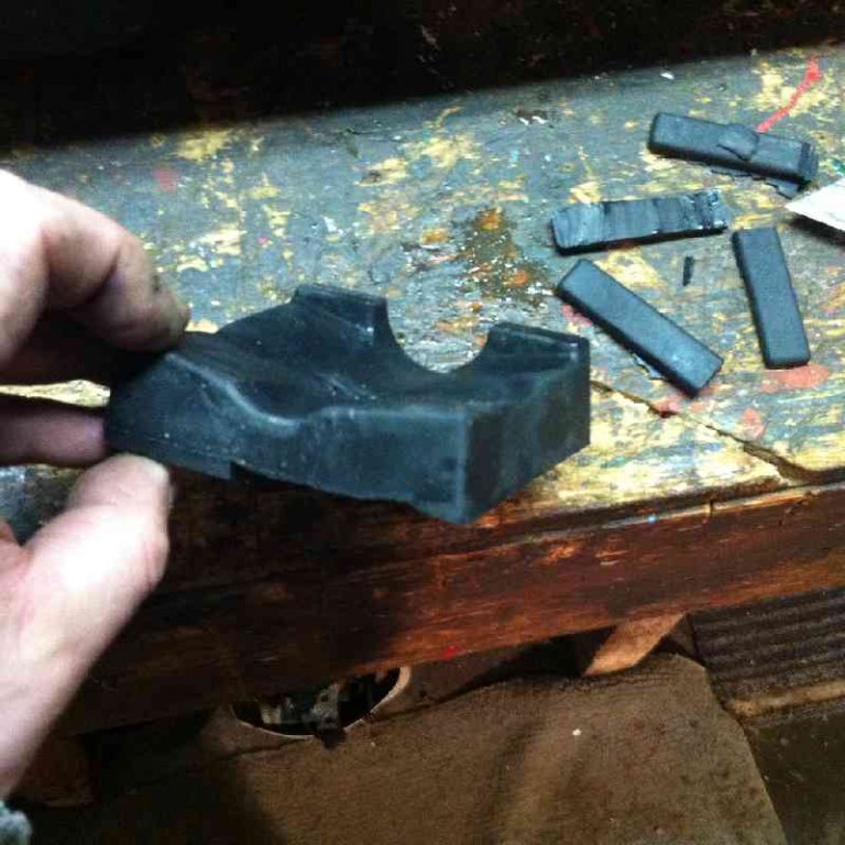

Using stock SW Rubbers:
Now we need to deal with the rubbers. While they are very close, and much closer then my cat was, I feel they do need to be sized up to allow for a "proper shimming" of the pilot ski, this means the ski will ride at a correct level to the ground, in order to help reduce darting and have good wear of carbide.
I went through a few scenarios, and mountings.....and ended up with what I feel will be really good for a natural built in shim using the rubber. On the DOOs we need to shim them as the pilot naturally(with BRP rubbers) likes to wear toward the front more, and then brings on darting. So we shim our DOOs with Scotts BRP shims. With the way I have modded the rubbers, the shim is now built into the rubber.
Front to back, the rubber will fit, albeit tight. Also left to right squeezes in too. So the overall dimension of the SW rubber fits into the pocket of the Pilot with some force, warmer the rubber is the better, so doing this at minus 30 is not gonna be easy. LOL
What is needed, to allow the bolt to be installed without 5 guys all pushing on spindle, is a small trimming of the rubber on the BOTTOM, forward most section. Flip the rubber over, and on the bottom there are two side "raised" sections of rubber......There is 2 inches from front of pilot pocket to a small ridge in center of pocket, we want to trim this raised section FLAT for 2 inches from front of rubber, as it will not only allow for an easier install, but will lend to a natural "shimming" effect since we like to have more height on the rear of rubber which pushes down on the rear of ski, raising the front of ski. Be certain you have the rubber oriented correctly, with the outside of rubber having the ledge on top(offset of ski stance) before you start trimming, so you have the front 2" of both ledges correct, then trim them off flat. Each ski rubber will have the opposite look when done.
Dan
