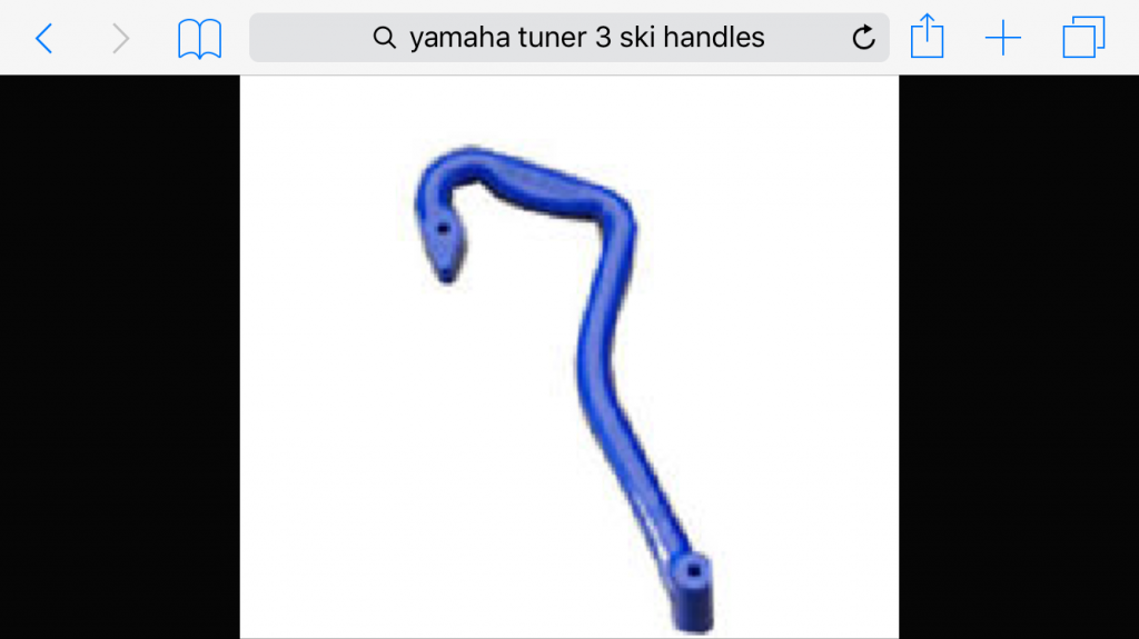

that is a good question, Doo offers several loop colors.....Just wondering if the blue loops are even close to the bright Yamie blue color or are they kinda dull?
I took a screenshot for you guys looking into handle colors, only see one blue though.
I do see 3 reds though,not sure which is best for red LE models.

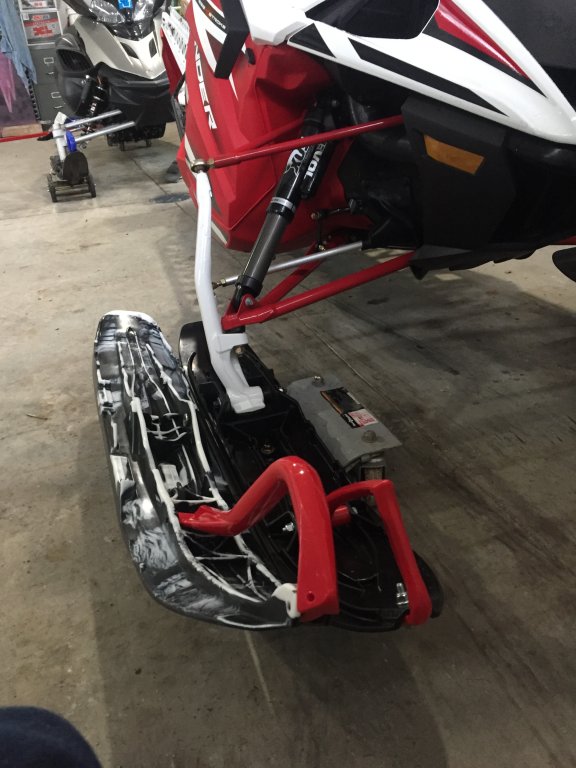

Nice looks awesome. Viper red it is for LE gang.View attachment 125634 The viper red matches the red LE perfect
BRP p/n # 505071059

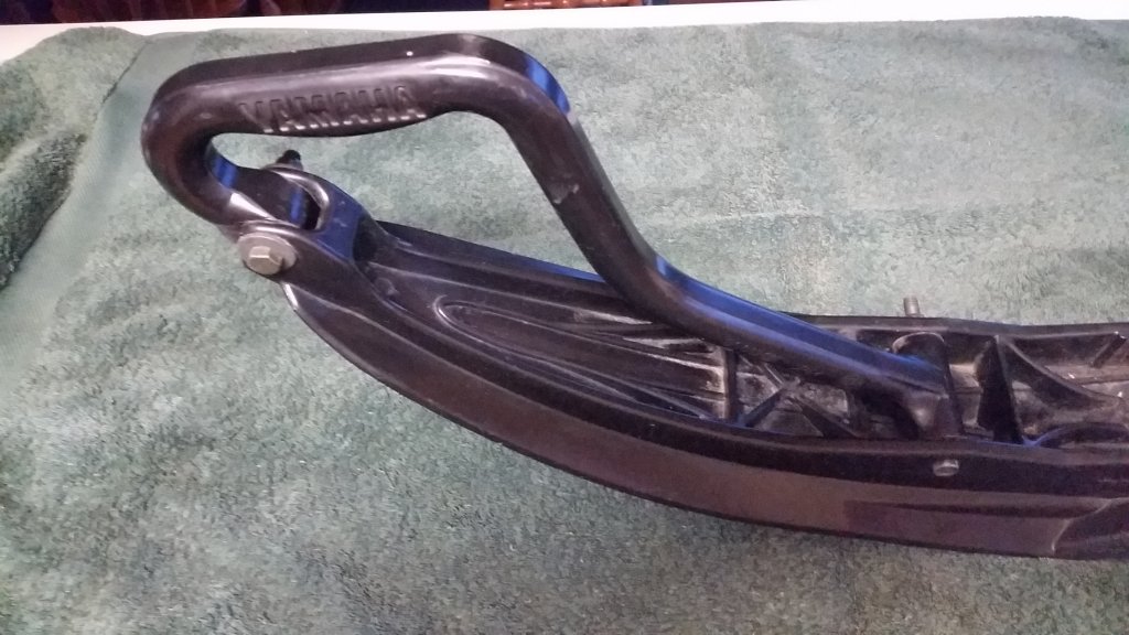

Old Handle..................................New Tuner Handle.
I was wondering that and almost asked! Good deal.
Dan is correct. The older single keel Yamaha ski handles would work with a little grinding but I do not believe the new tuner ski handles will work. Not without major mods and drilling.
Front of handle bolts differently.
