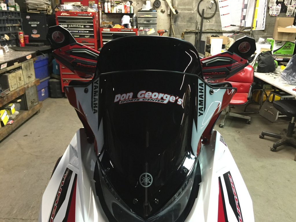

I am with you Don,mine is midheight Yamaha shield,now I just need a sled that is all togeather.lolView attachment 125661

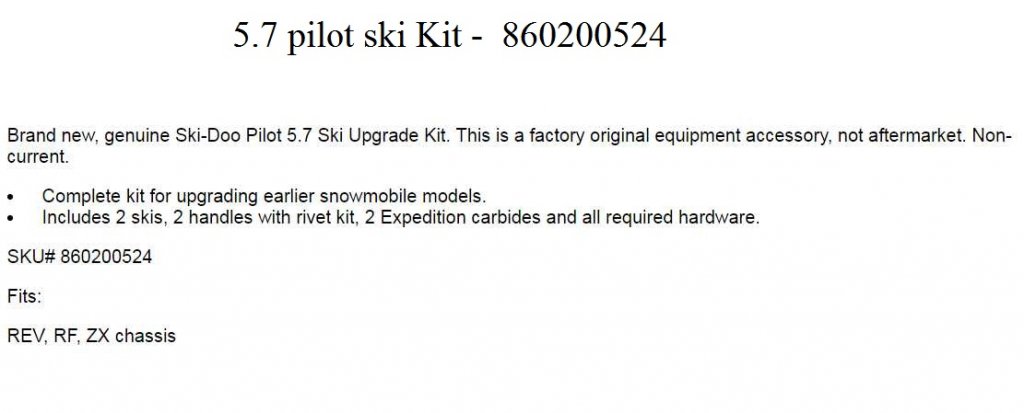

Any of you guys just wanting a cheaper setup for trails, the 5.7 does work well, and the bonus is you can find takeoffs on DT cheap.....also BRP sells a 5.7"kit" with basic carbides, handles and all really cheap. My dealer sells tons of these kits around 200 NEW!Found a brand new set of 2017 850 take offs for $200.
5.7 pilot kit part number..... 860200524
Leaders has them here on ebay, just remember you want to buy the 8" carbides for center and use the stock basic ones on outers that come in kit.
