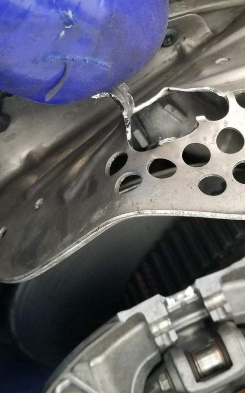

Just got another private message of another sidewinder clutch coming apart. Same spot where I show the cracks from where the allen screws hold the weight pin sleeve. Took out his clutch guard, turbo tube and hodd/side panel.
Someone is going to get seriously hurt here!

How much HP? Not stock I assume?Just got another private message of another sidewinder clutch coming apart. Same spot where I show the cracks from where the allen screws hold the weight pin sleeve. Took out his clutch guard, turbo tube and hodd/side panel.
Problem is, YAM doesn't give a crap about boosted sleds....If it works stock, is all they are worried about. At least they used to, not really sure anymore.
All those big Winder early sales, over the cat 9000s....all cause we all felt YAM clutching would be superior. And so now more guys will buy the Cat 998 is my guess.
Dan
This is starting to get my attention. I don’t go full on sky is falling over a couple incidents like a lot of people do here but there is starting to be enough to take notice. My only problem is there’s very little info on the specifics given to us in any of these cases. Reported cases, no background info. Even this thread here. A few posts to start off and then nothing, no follow up answers to the lingering questions. I’ll keep a close eye on my clutches and components for now. If I had to make a choice right now I’d probably go to the old Yamaha primary. They’re tried and proven on big hp and I have a lot of experience with them and tons of parts.
Many have switched back to the old style primary and having 0 issues....myself included.
This is the pic I received yesterday. Believe the sled is stock flashed.
***Update to my post here***
The sled is flashed stage 2 for cold air intake and exhaust but running stock weights with added weight rivets.
Yikes...that picture says it all.

What the heck is everyone torquing those tiny little set screws to? Perhaps overtorquing with too much loctite then once it gets hot it expands.
