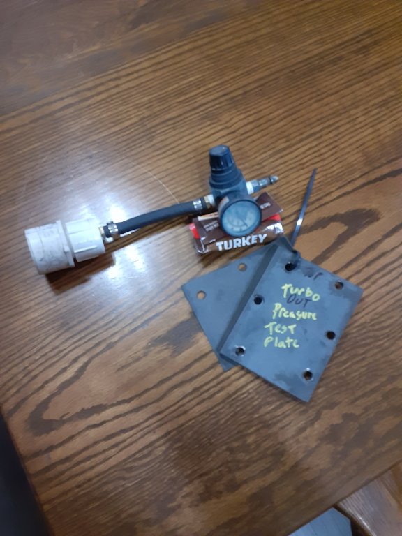

Merry christmas, to do mine i gathered up a air pressure regulator, a trip to my local hardware store for pvc connectors to hook into intercooler hose where it comes off turbo, drilled and tapped threads into pvc cap on, threaded air hose nipple into the cap, hook the air hose to this, turn up air regulator up to 5-10 psi rotate motor slowly by hand counter clockwise till you get the least amount of air leakage out of motor, listen for leaks, opps forgot after you find the sweet spot turn reg up to about 20psi then check for leaks by ear and spray bottle with soap and water, you will hear some air going by the valves no way to totaly get no air passing by someplace in motor. Hope this helps, i believe turbo dynamics has a video on this also.

Do a SEARCH in Sidewinder section.
I think Turbo Dynamics started one & many chimed in with their homemade tester & how to do it.
There's also a "pay it forward" post by BEERMAN that shows a simple one to build
