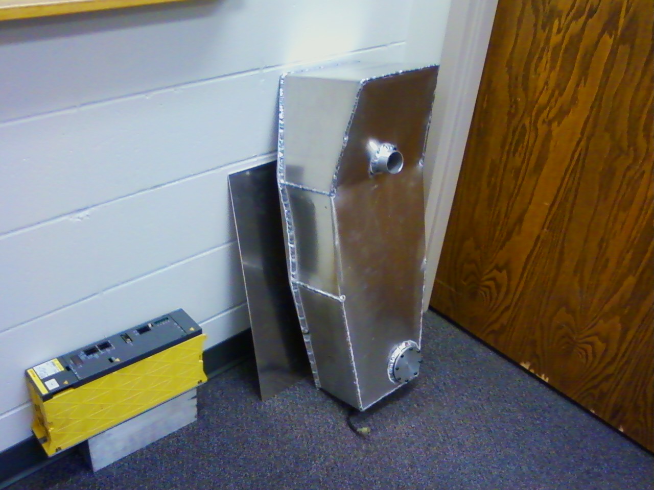

progress
I have been going into work early a few days and have my tank nearly complete. I need to pressure test and find the leaks as I am sure there will be a couple. And add a breather port. Either way here is a pic of the tank. After I put the tank on all that needs to be done is braces for the ic and wiring and some assembly. Which all could be done in a good saturdays work.
Capacity? Great work dirk
