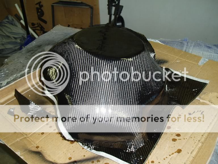

My first attemp to make my vent kit was not so sucesful. I was not happy with the result, so I started to make a new one. Here is some pics from the start of building it.

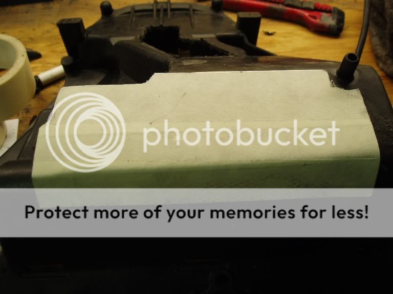

I started with to make the shape that I wantyed with tape
The I did make a thin shapen in fiberglas
Then some carbonfiber

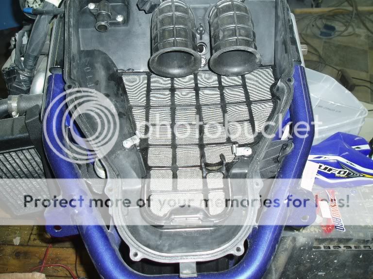

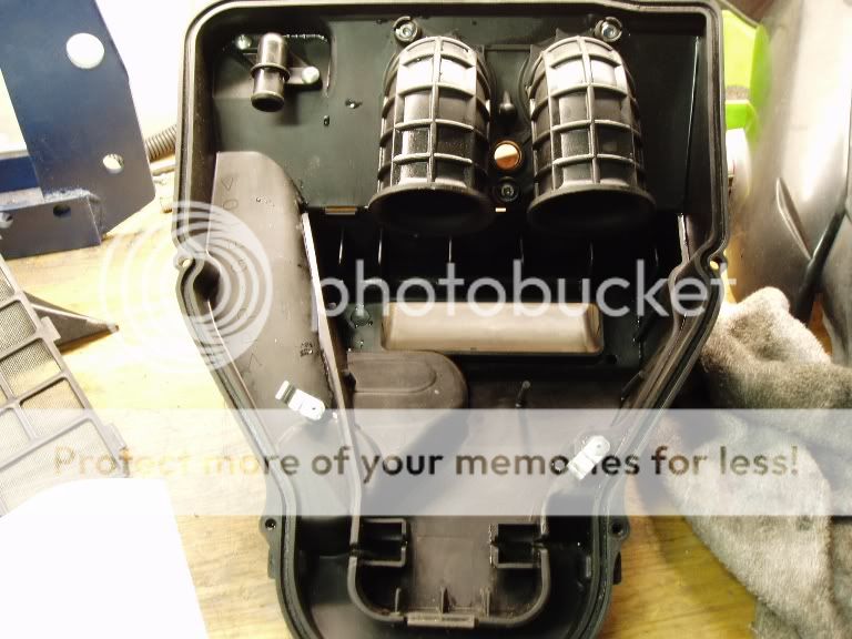

Coldairintake is beeing planned
Here the new intake will be..the area is bigger that the original one

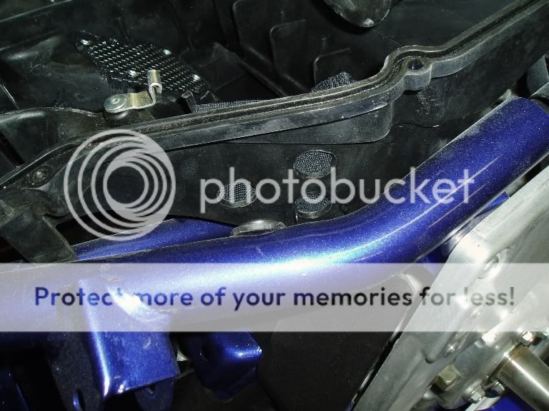

The original airintake I did close with a plate

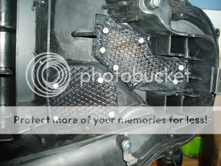

The holew are covered with mesh fabriq and grill
I did also drill 3 holes on the side, there can never be to much air into the engine I think
Here you can see where the air will come into the airbox
All the new intakes are under the original filter so all air will be filtered as normally
I have also made some more jobs on the carbonfiberparts to the vent kit
