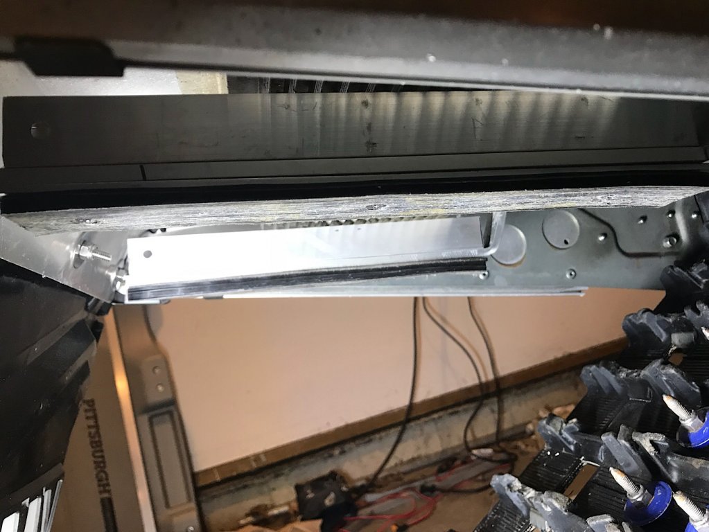

Steiner, where the screw heads are, are only the rubber track lugs, no picks. My picks all run up the middle of the track, between the protectors. I figured the rubber lugs would run right over the screw heads. Easy to change if I need to, so let's discuss! I could remove and counter sink a bit too.
That duct tape was only there too, as a third hand. It held the custom protector tight against the stock one while I get the rivets in.
On the track depth, yes, I agree, those lugs are pretty soft too and flex, so what I did was take a measurement of the pick height all the way to the base of the track. I then transferred that to the protectors I made to make sure the protectors and distance to the cooler was slightly more, so they definitely cannot hit the cooler.
Exactly.
Those screw heads will catch on the track and tear more of the track off. Been ther dun that.

Ok, so I can find a flatter head screw, countersink, or rivet. I prefer not to rivet, as I like the idea of being able to easily remove them and replace if needed.
Originally, when I fixed the stock protectors (where you can see the hole drilled in the rear cooler protector to allow it to sit flush), the consensus was the the screw head was not an issue...
What about a screw like this, that would be a bit countersink and pretty flat along the slider?

Picked up some flat head screws like the ones above at lunch. I'll countersink and install tonight. Done!

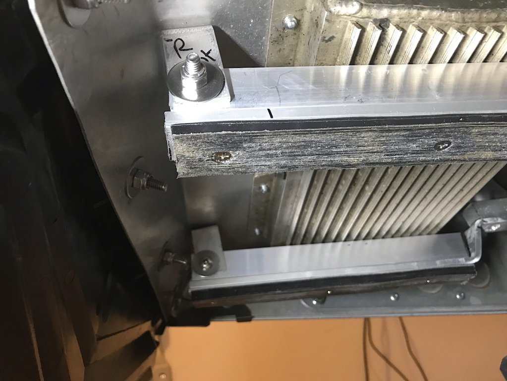

Ok how are we feeling about this now with flush screws? Looks good to me.
View attachment 132812 View attachment 132813

Mounting brackets for the back tonight, and cross this one off the list and move this bad boy into the trailer where it can nap for a few weeks till the snow is flying and the trails are open!
