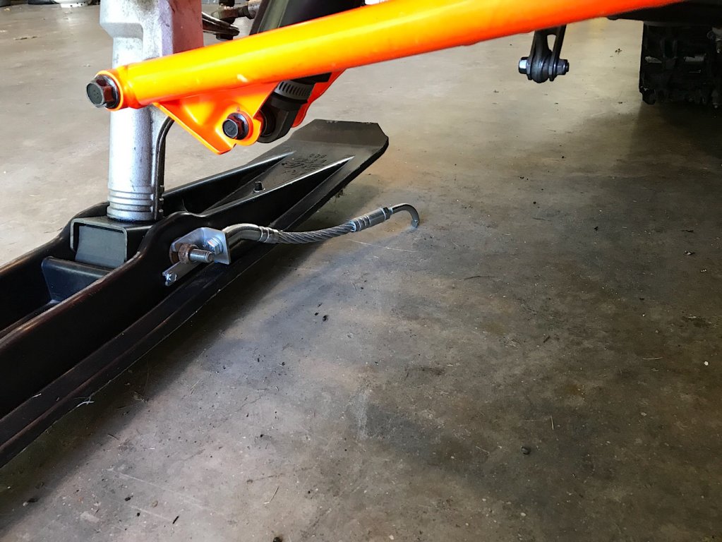

Got the scratchers on using the BOP ski scratcher mounts. Looks good and should really dig up some snow! Just not sure how to secure them up if I don’t want to use them or am on pavement and trailer loading and stuff. They don’t stay on top of the ski.
View attachment 130565 View attachment 130566 View attachment 130567
With so many different ski profiles, I have not yet come up with a simple retainer yet that will work on all. Currently I'm exploring a bracket that can be attached to a skag stud. This would eliminate drilling a hole in ski.
Travis that is an excellent idea! And I would buy something like that. I have C&A skis, and the profile towards the back is very low, as you can see in the pic, so not much of spot to mount an eye bolt. Something coming off the skag stud would be perfect!

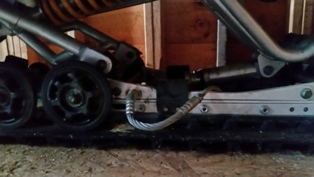

This is the photo of mine.. if you ever need this mounting. I leave them down alot..in and out of the trailer as well. No issues ever...they never come off the rail themselves. The mount is in a bolt hole already there by Yami. Throws lot's of snow into and on the track. Wife has them too on here LTX

Thanks. That didn't seem like a spot available to me. Hmmm. I did mount the low snow wheels though, so I wouldn't be able to hook them there if I wanted to. I'll start out with them on the skis, and we'll see how it goes.
