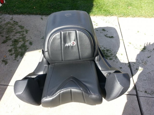

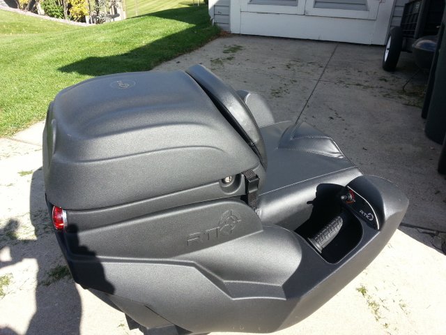

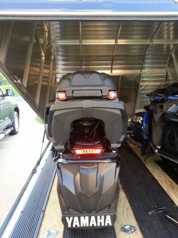

Just finished adding an RTK passenger seat to my 2015 r-tx-dx. It has LED running/brake lights, 2 setting heated grips, locking storage bin, and takes less than a minute to install. My wife would like to get out but doesn't like driving so she can join my son and I once in a while now and head out for Lunch.
I bought this seat used from a member, but they are available new from RTK industries in case anyone is interested. It fits the Viper very well and is light weight yet sturdy. I mounts with 4 bolts in the tunnel holding mount pins. The seat just snaps over the mounting bracket/pins. The electrical is 2 plugs. The added rear lights just tap off the harness under the seat. I ran an accessory line from the switched accessory plug just above the exhaust/chaincase. I used a "y" splice to also run a 12v line to the dash for my heated shield. All lines have separate fuses and heat shrink.

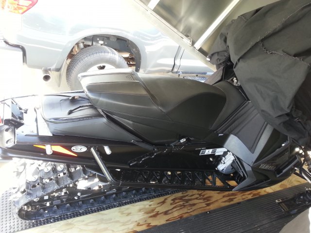

Can you take a pic with it off. Just wondering what it looks like when the seat is off. Thanks
I'll take a few pics with it off tomorrow. Are you interested in the seat off the sled or just the sled/mount?
Curious what the mount looks like on the sled without the seat
[/ATTACH]
[/ATTACH]

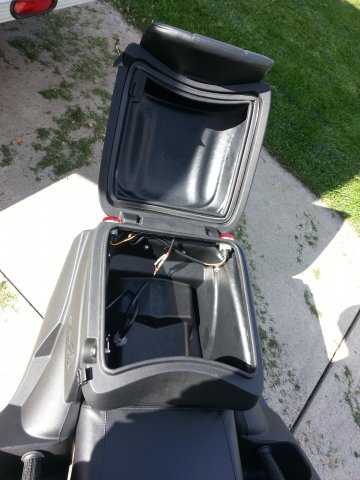

Here you go. The 2 cables left hanging out on the rear tool bag are what plug into the seat. A few pics of the seat also.
Thanks that doesn't look bad. I just didn't want some big ugly brackets when the seat was off. I like it
