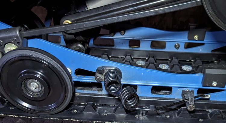

Hey Glenn, I bought a set of these, thanks for the tip. Do you happen to have a picture of where you're mounting them on the rails perhaps?

Great question Mike. I believe different year winders might have a different assortment of holes in the rails. Here is how I mounted them on my 22 LTX SE.Hey Glenn, I bought a set of these, thanks for the tip. Do you happen to have a picture of where you're mounting them on the rails perhaps?

This is exactly how I have these mounted on my '19 and '23 LTX.Great question Mike. I believe different year winders might have a different assortment of holes in the rails. Here is how I mounted them on my 22 LTX SE.
Thanks Glenn,
Great way to mount them, looks like you just drilled one hole thru the rail. No issues with the upper guide wheels hitting the spring or hanger when bottoming out? Maybe all you ride it those smooooooth groomed trails though.
I see you have the old 17 wheels on there, do I remember correctly that you had issue with the new spoked wheels blowing up and chunking off the rubber?

No issues with them hitting anywhere after 3 seasons. I've had several buddies mount them in the same spot without issue thus far.
I was gonna edit the pic and crop out the wheel, as it is an easy trick that nets an extra 2 mph......lol...... but decided to leave it as a reference point to mount the scratcher. I didn't think anyone would notice, but not much gets by you. Lol
The wheels are ski Doo wheels, which are 1mm bigger than factory Yamaha wheels, but much more durable. They were the closest/best replacement I could find and I put them on all my sleds now.
