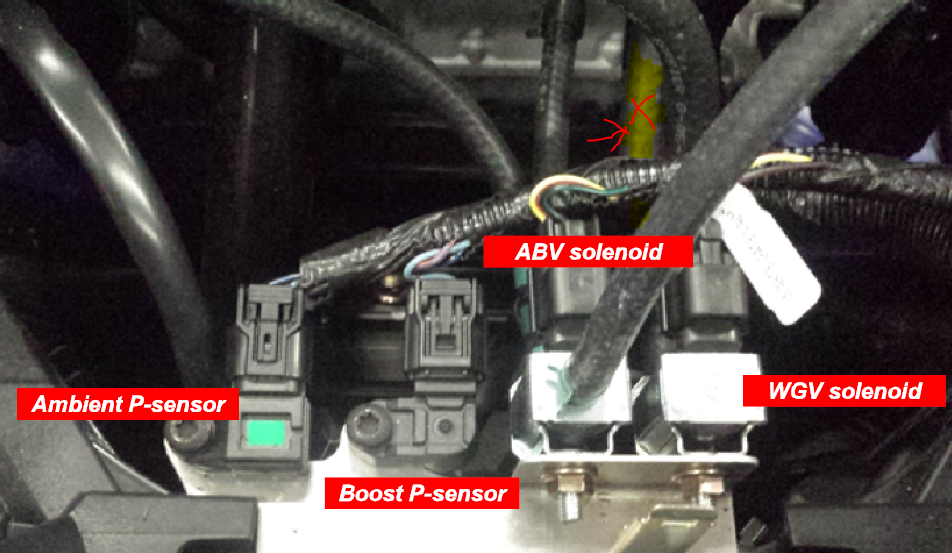

So I talked to my Service Manager (who is a champ, btw) and he did a little homework for me. Yamaha has suggested that the line from the back of the airbox be disconnected, then cap off the airbox nipple. leave the other end of the line connected to the WGV solenoid; let it hang down and secure it with a tie. Apparently being connected the way it is (stock) can give false readings and is not needed.

.View attachment 146251
I coded today with a stage 3 precision tune. First time I was able to really stretch the legs on the machine since it was tuned and it cuts power at around 95mph in loose conditions . How did you make out unhooking the sensor?
