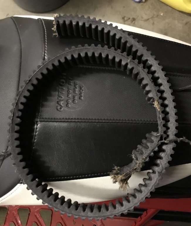

400 miles on my SRX. 1 first belt blown after using alignment tool and removing 2.9mm.
Brent why the 824 if i may ask? 1 13/32 width x 44 1/4 long vs 1 7/16 wide x 44 3/8 long for 825.
Like this or multiple pieces
