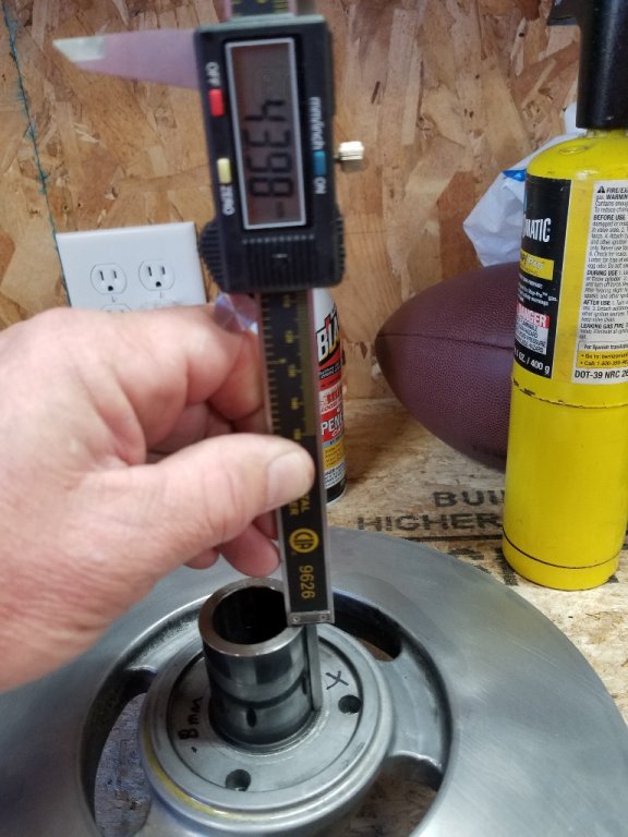

Bought a used secondary and it has 8mm shaved off it. Will this still work? I realize I'll need to add shims but will the sheave hit the bearing mount?
8mm! Anything more than 3.5mm and it has no clearanceBought a used secondary and it has 8mm shaved off it. Will this still work? I realize I'll need to add shims but will the sheave hit the bearing mount?

Well, I guess I got screwed then!
If you have 8mm machined off the back hub the hub would be recessed by about 4mm from the back of the inside sheave

Just space it back out with shim washers. Still useable.
Dont know if you saw my measurement pics but do you still think it will be fine? Worried belt wont drop in far enough. Also, I have osp belt adjuster, will I need to remove material from it like the stock one?
