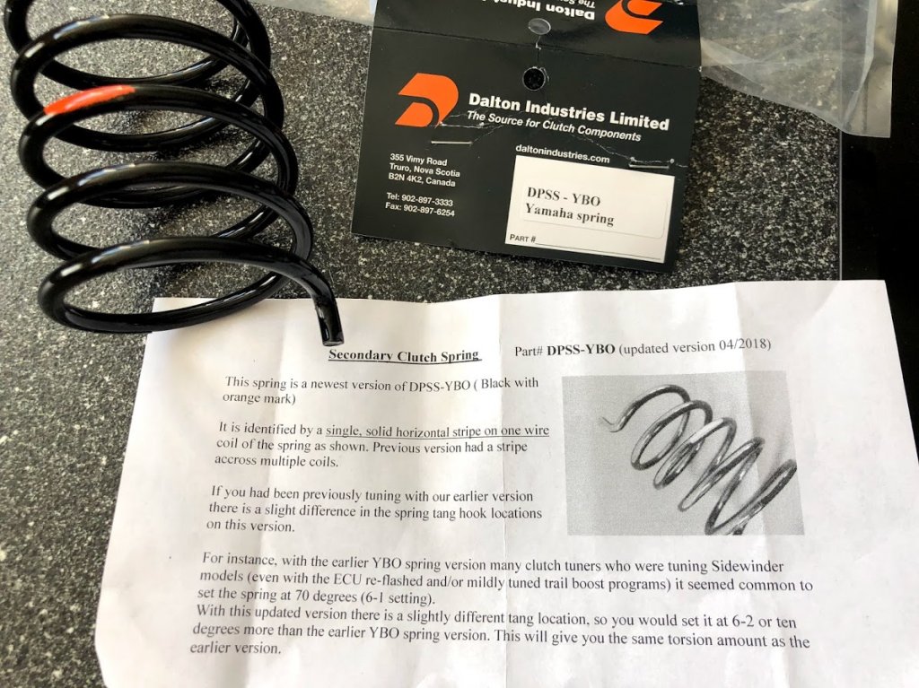

I still have my original B/O but Dale sent me updated one and its arriving tomorrow, I did not realize the new B/O has a diff wrap recommendation....Im an old MachZ guy and with the doos we always use a fish scale to check backpressure tension, While the Doos are generally set to 16lbs avg, my orig B/O at 6/1 avrg 14lbs. And that seemed to work well. So ill check this new version, but sounds like Dale made a change.
So you went with both the cluster flash and also the flasher? I will have both too, but just cause in season two and already had flasher. LOL
Dan
My Replacement Dalton B/O just arrived here. New instructions below.
Dan

That's the same instructions I got with mine and I will try it there. Hey Dan where did you get your Dalton weights and springs. In the USA or Canada? I'm just trying to avoid high shipping costs. Thanks again mike

How were you able to keep the original B/O spring.yeah the cluster flash is coming very soon Ive been told.
Dan
They made me destroy mine and send a picture as proof I did so before they would send out the updated one.

Mine is being sent back, Dale prefers to have all of them out of the public to avoid issues or confusion, a very heads up thing to do IMO.How were you able to keep the original B/O spring.
