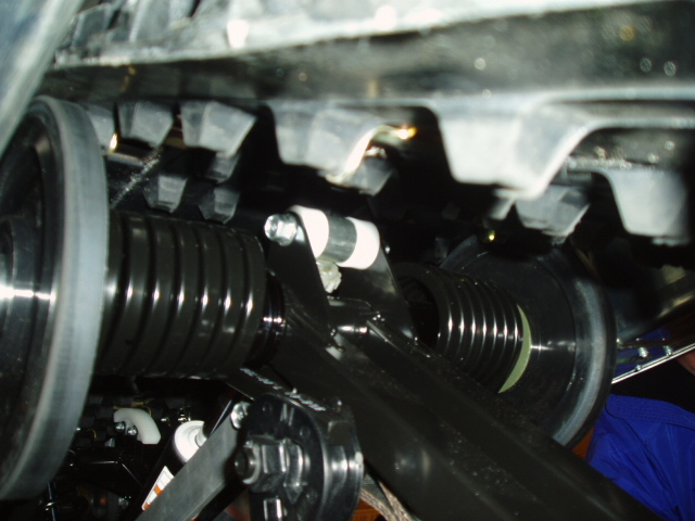

No, they have a plastic roller on each side of the shock (the white that you see in the pic) on the FX Nytro.

If you suck the limiter strap up one notch from factory, the rubbing should stop.............
As far as nylon goes, I don't believe there needs to be ANY moving parts.
A flat plate that would bolt on to the upper shock mount with a 1/8" thick piece of delrin or nylon about 2" square would do the trick.

Sucking the limiter strap up one hole seems to change the approach angle just enough to flatten the rear angle out so the shock isn't as high as it is when the strap is loose.
It's not much, maybe a 1/16th or so, but it(mine) doesn't rub.

Srxspec said:The bearings aren't in constant contact with the track. We will be updating the design of the rub kit, but it will be more expensive due to machining costs. The new kit will be $70. I will try to take some pictures of the new design installedm, but here is an 3-D model of what it will look like.
Kit Components:
2-Nylon Wheels
4-Roller Bearings
4-Shields to protect all the seals on the bearings
1-Replacement bolt
Just an fYI
I made the same set up you are selling out of nylon wheels with bronze bushings pressed into them.
I am sure you could substitute the bearings you want to use for bronze bushings and cut your costs some.
I have almost 2000 miles on mine with absolutely no issues.
Again this is just an FYI not telling you anything is wrong with your idea.
Good luck!
