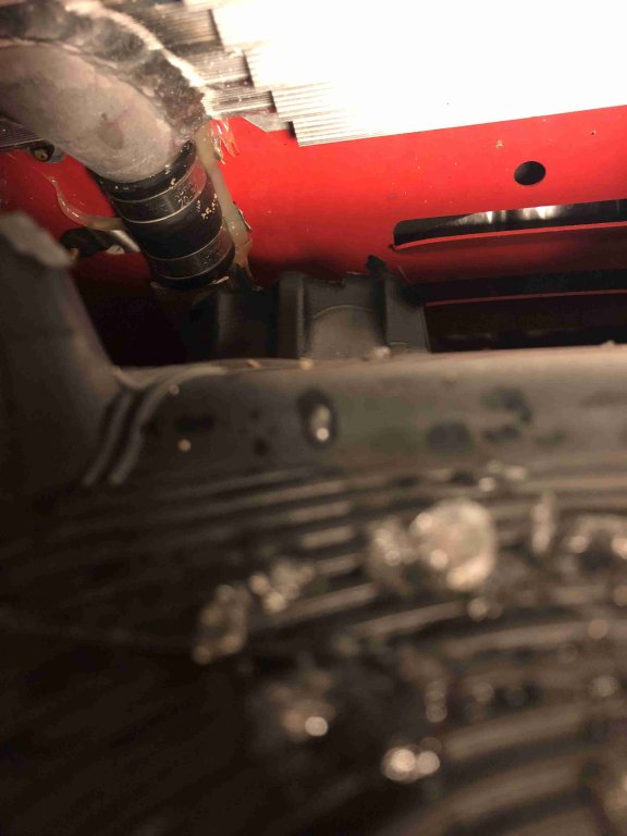

Me and my buddy just got back to the motel after are 3 day ride that turned into 4 with both new sleds ending up at the same dealer with having to replace the same hose. Here are a couple pictures of the hose. When we were riding it was -25 f. We slam the back of are sleds every morning and run them in reverse to get the ice out. I'm sure I knew when it happened as I heard a huge sudden noise of a chunk of ice hitting the tunnel. When the ice hit the tunnel it actually dented the top of the tunnel up a bit. In one of the pictures you can see how the hose is not straight. There needs to be some sort of guard made so this doesn't happen again. Me and my friend make 3-6 day saddle bag trips putting on over 200 miles each day. We're a little hesitant on going on are next one but when we get home we're going to see what we can do to protect it. I will share what we try!
It seems to me you would do more damage reversing track if ice chunk goes the opposite way, going forward the hose is up higher then the alum tube, and ice should not hurt it. I could see going in reverse this happening though.
Here is a pic from rear and front of track, you can see how ice going the wrong way could cause damage moreso.

Do you know how much grit, sand and other items get pelted to the front of the tunnel running down a road. That joint will disintegrate over time. Even the abrasion from small ice pellets let alone the chunks.
This is a huge flaw. Someone has to make a guard (bent aluminum) that can be riveted on the underside protecting that joint.

What we were told by the dealer is that the chunks of ice get hurled to the front and actually force the front part of the connection up vertically causing the connection to become offset or S shaped. This either stretches the hose enough to tear it or it is cut by something up there. It's not actually cut by the ice, but the fact that the front part of that cooler has been forced up and needs to be hammered back down to make the connection straight again. Something needs to be reinforced so the front part of the connection can not move up out of position. This is what the dealer told us happened.
Are you saying the front heat exchanger is actually moving, flexing or buckling causing the hose to kink?

Yes. The tunnel and heat exchanger are getting bent and pushed up causing the hose to not be straight. They beat the front part down with a hammer so the two hose

In the apex and nytro the heat exchanger forms part of the bulk head at the front of the tunnel. In the pro cross it is a separate piece that is fastened up in there and can move. Didn't think could though....
