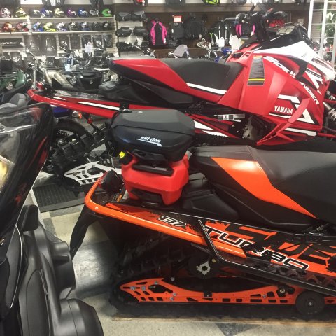

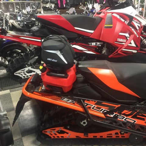

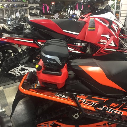

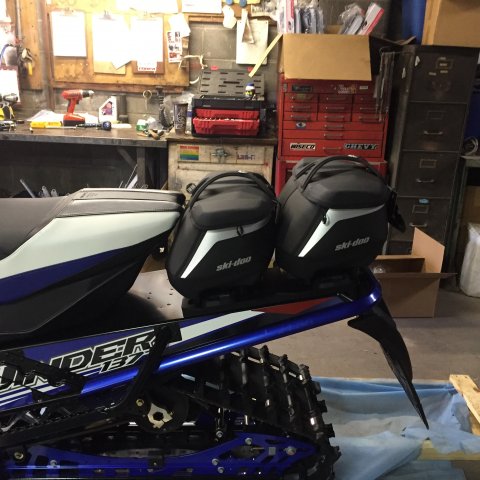

Smaller tank can not stack. Here are some pics of the larger 4 gallon tank and single LMP-1 mount with multiple combo's. Stock bag can stay on 137 models.
I think the sr21 bag and tank combo is the best set up. (First 3pics).
