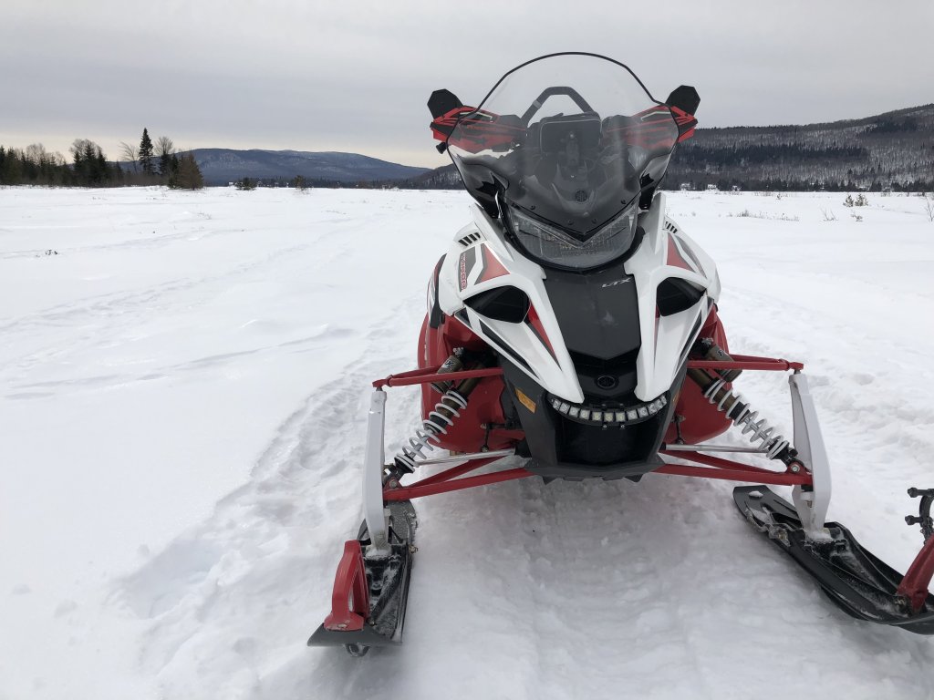

are those tuners with snowtrackers ?View attachment 138081
Guess which Yamaha wouldn’t start this morning. NOT the Winder. Bye Bye Attak
How do you like them in the trails ?

. No.are those tuners with snowtrackers ?
I would not run the Tuners. Those are 2017 MTX Viper Skis with semi-agressive snow trackers. It is very hard for me to do adjusting and testing because my rides are trips with hours of trailering. From the start my sled had way too little ski pressure. I made multiple adjustments before heading on this trip and had to back down a lot this am. I pulled up limiter straps to midddle hole. Tighten rear center shock and reinstalled transfer stop rod only with no blocks (removed Racewerx adjustable) I hit the deep snow this morning jumping on Lac Oaureau and the sled was very unstable. I loosened the rear center pre-load to as close as it was before as I could and then rode the rest of the day. I wanted these skis to be good on trail and off trail. At this point the on trail manners and damn good. Point and shoot. way more confidence than previously but I don’t care for these skis in 12” or so of snow.
