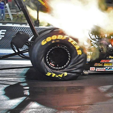

I defer to your experience but..
Well, yes of course there is ballooning under power but the two look very different is my point, if for no other reason that you do not have the limitations of ground, traction, and driver induced track tension when the sled is on the ground. When you engage the clutch, all forces come from the drivers pulling the track forward across the top, this translates into pull backwards at the bottom. There is a nearly continuous line of tension from the drivers over the top of the upper idlers, around the rear, into the track on the ground, is it a linear path wheel to wheel, of course not, it will follow a speed dependent path that itself is a balance between driver induced tension all the way to the track on the ground and the centripetal forces trying to balloon the track. An easier way to say this is that snowmobiles move forward because the track is being pulled backwards out from under it. This alone makes the ballooning very different. I agree, with a very loose track ballooning could become an issue. Don't run a loose track is the moral of that story.
Your dragster analogy is the perfect example. In the below image all energy comes from the center axis of the tire but the tire does not experience uniform tension, expansion, or distortion. If you start at the end of 'goodyear' below and look at how the tire distorts it is clear that the greatest tension in the tire comes from where the tire hits the ground. As you follow the circumference of the tire around you can see a lot less tension in the back and top of the tire and then the tire starts to experience more tension as the energy is transferred into the ground.
If the backend of the rail were in the air there would be uniform distortion of the tire and equal ballooning all around. Because it is on the ground, it will expand (a lot) but not uniformly.
You can see the uneven distribution of forces even better in slow motion, a microcosm of what is happening with a far more complex snowmobile track drive.
Jvji24
- Mar 1, 2022
- 172
- 75
- 33
- Wi lakes
- Tcats
Polaris
Single ply sucks. Under hp they balloon all the way around.
Your dreaming in a perfect world as if the forces on the track are even across the board.
Uneven track tension, track changing directions around the wheels, studs and stretch all play a part in the force on the track.
Dont forget tracks balloon up in the middle not just in a circle.
Run a 2 ply track on a sidewinder.

A snowmobile track does weird stuff under the tunnel at high speeds just as these tires do. They get some weird waves under there that people don't even know about unless you stick a camera in there to have a look, which is easy enough to do now, but you can see the same stuff on the track dyno when the track is not tight enough. Tight tracks lessen the wavy and balloning effects by quite a bit. Loose tracks rob speed and have been known to break suspension guides off the front arm and of course rub tunnels, tunnel protectors and heat exchangers.
When they hit the tunnel too hard, its like putting the brakes on literally, sometimes it slows a sled tremendously of what could be if they didn't hit. People are always concerned how a track turns, by hand on the stand while off the ground. I am too, but the opposite of what most people do. I want it to turn hard and with two hands, most people not in the know, want them to spin easily with one finger and rotate round and round, which is not what you want for going fast. Testing will tell one what is quick and fast.
