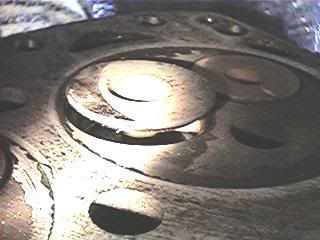

Iceman57
LazyBastard said:I said SPECIFICALLY that a valve NEVER stuck. And I know because I was there and peaked inside the engine.
LazyBastard said:Also, if the valves get stuck open, the pistons will actually HIT them, which would do one of two things;
a) eventually work the valves loose,
b) cause damage to the valves and pistons - this would be a HUGE major rebuild and would cost thousands.
And incase you've never worked on a 4 stroke engine....especially a head......a valve could be stuck open and not hit the piston. Your either unexperienced with 4 strokes or in denial.
And how do you know a valve never stuck? did you work in the sled. Did you use your crystal ball to look inside the engine. I'm saying its POSSIBLE that a valve stuck, your denying that could ever happen.
Valve stuck open......but wait that could never happen
