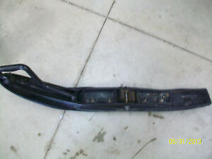

I am looking for snowtrackers for this 2009 RS Venture with original skis
I am pretty sure this is the ski on the sled
https://www.yamahapartshouse.com/oemparts/a/yam/5003c723f8700212fc842fae/alternate-ski
No. 12 on the bottom part diagram
is the 19414 the version that I should be ordering?
The makers are suggesting 19414 for agressive and the charts I am looking at mentions something about skis with skins
Venture All 06-10 Ski with ski skins 19416
and then something in the Quick Reference
https://www.snowtrackerusa.com/pages/copy-1-of-choose-from-the-three-products-below
Quick Reference Universal All Steel Skis 19313
Quick Reference 06-10 Shallow Keel, 3 bolt 19412
Quick Reference 03-12 Alum.saddle 4 bolt 19414
Quick Reference 07-19 Ski with ski skins 19416

I believe this is the ski on the sled
(no. 12)
(no. 12)

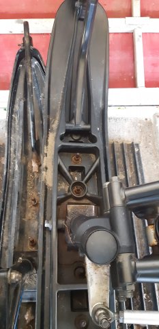

Well i think I found it...
with maim's hint towards the VK id did find that the ski on this 09 RS venture is one of the alternate options that is used on some VK pros.
19414 (aggressive) is the one that should go on this ski/sled setup.
ordered and will keep updating this thread.
