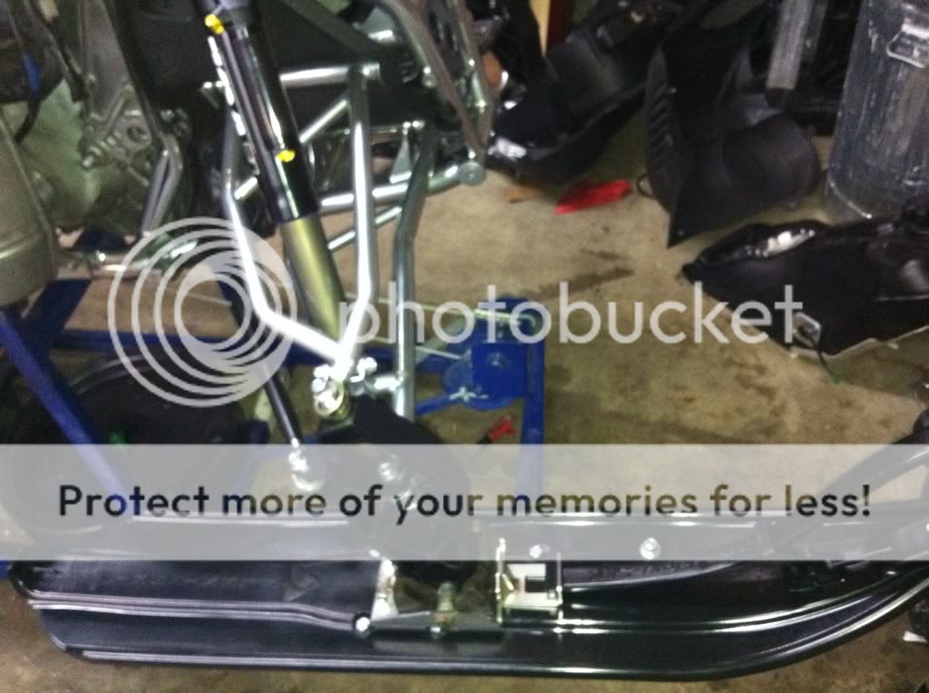

Skinz Super Chrome Front end partly installed with new Fox floats.
Stoli
Finished up the front end tonight, added 2010 black powder coated spindles and Simmons GenIII ski's. Added the oil to the lines to the turbo and adjusted the idle scres. Installed the OFT Roll-Over valve and finished the lines to the air box.
