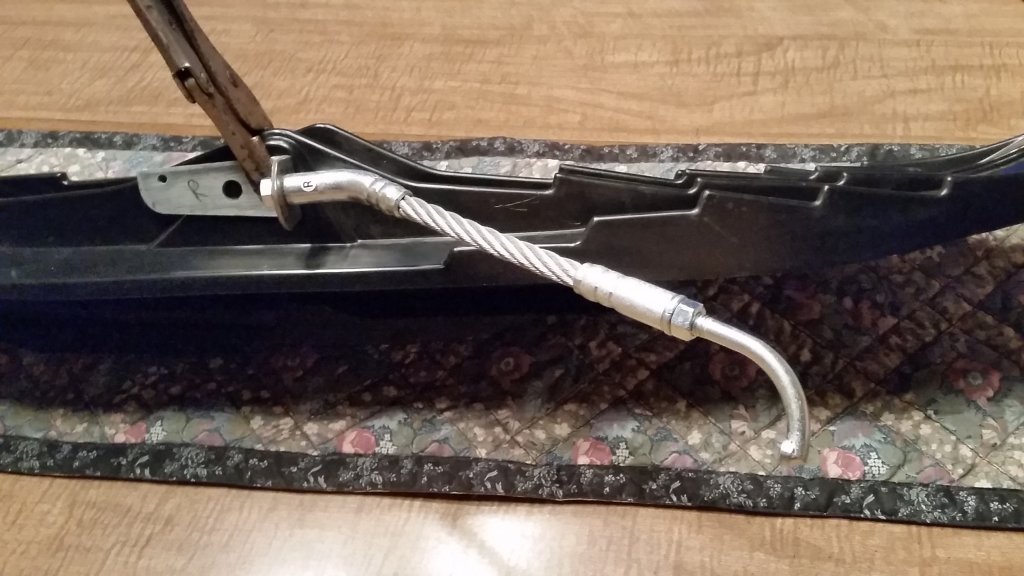

I made this quick mount for the weekend trip
Worked pretty good, just needs a little tweaking

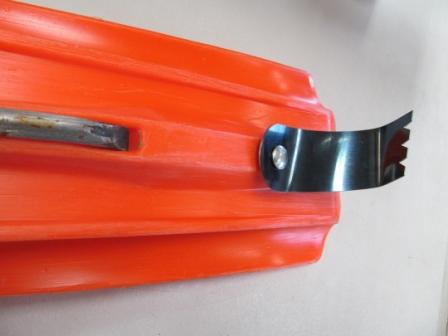

I had 2 problems with the Duraflex style scratchers
1) When mounted on rear suspension, they would jump around & hit track. My track has scuff marks to prove this
2) Can't be mounted to plastic ski because there's no way to keep it from spinning & loosening up
-must use metal bracket like above pics

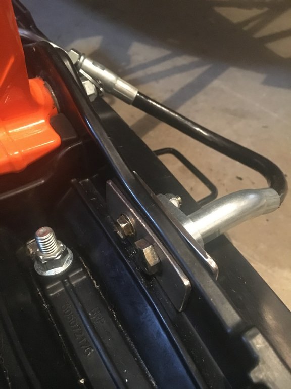

Thought I'd share my experience with mounting the cable style scratchers on my pilot 6.9's.
I used the Qualipieces brand - same company that make the cobra head carbides - mostly due to their mounting design which has an anti-rotation feature. I had 2 goals in mind for mounting. 1 - be ski mounted rather than skid mounted. 2 - utilize hardware that can be removed with the tools in my tool bag so the scratchers can be stored in my travel bag when not needed.
I wasn't sure the plastic rail on the skis were strong enough to take the torque that the scratchers so I made some brackets out of stainless I had kickin' around to strengthen the joint. I made up some plates 25mm wide X 70mm long and drilled holes to match the brackets that came with the kit. Large bolt takes a 14mm wrench and smaller one takes a 10mm. quick and easy install/removal. pretty happy with the fit and finish. hoping they work well for cooling!
