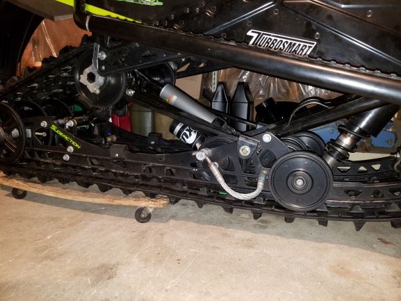

Most of the time, I only need one of these Duraflex down they work so good. I also have their accessory hangars.

Rail mounted? I just hear of so many having damage from these style mounts.. I have never been a fan of the cable style... Looking at the heat exchangers on this catalyst I may not need them.. I keep telling myself this but I know of no sled that runs on early morning hard pack without over heating? Maybe the wifes 2012 570 fan? LOL.. That was a good machine actually.. pooch but good runner.Most of the time, I only need one of these Duraflex down they work so good. I also have their accessory hangars.

This is an early pic. To keep scratcher end from hitting rail, I just strategically installed rectangular piece of UHMW onto rail. Done. No damage done at all to rail or surrounding. I can see where scratcher carbide end has hit UHMW.Rail mounted? I just hear of so many having damage from these style mounts.. I have never been a fan of the cable style... Looking at the heat exchangers on this catalyst I may not need them.. I keep telling myself this but I know of no sled that runs on early morning hard pack without over heating? Maybe the wifes 2012 570 fan? LOL.. That was a good machine actually.. pooch but good runner.
